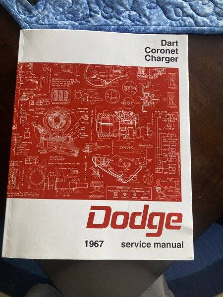

I ordered up a manual from Amazon, supposed to be here the 23rd? When I get back home, traveling, I'm going to do some more investigating. One thing I want to do is pull out the square unit below the glove box and check the number from it against my parts manual to see what it is. Hope you all are doing well wherever you are.

I learned something after perusing the FSM. The wagon came with a 273, not a 318 like I originally thought.
