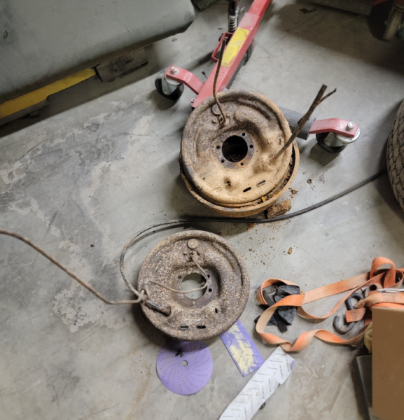

It won't help but here's a photo
They look like they will fit. They are the same for 8.75 and Dana.
I've swapped them around no problem. As a matter of fact, as I remember Pickup truck 8 3/4, E-body and C-body housing all bolted in the same and axle shafts were close enough to interchange as well.
If the brake shoes and drums (2WD not PT 4WD) are the same is a good double check. Some C-bodies had wider brake shoes.
If they are off a truck and are 2 1/2 inches wide, they will work. Those will fit 8.25, 8.75(not a stock a body 8.75, unless big bolt pattern axles are used), 9.25 and Dana 60. Look at a couple of my ads for brake kits and the 11-inch kit backing plates are from trucks.
