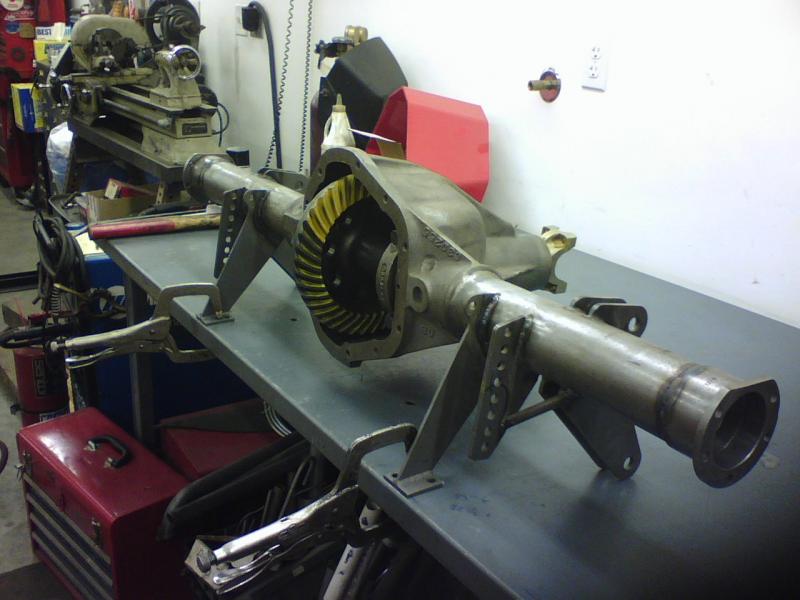

My Dana 60 is out of a E350 ford van. Narrowed to A-Body width,Strange spool,35 spline axles,S&W ladder bar brackets and shock mounts. 165lbs.

I recently built a complete a body width Dana 60 out of a ford. With a posi and complete with drums no fluid and 35 spline axles it weighed 210lbs. Disc brakes save alot.
A standard type housing like dvw posted is about 5lbs heavier than an equivalent S60 my brother has in his dart. An HD housing with the extra webbing and thicker tube will weigh about 22lb more.
The nice thing about the S60 though is the spanners to adjust vs having to use a case spreader. That amount of money for 5lbs though?

If your housing looks like what dvw posted then its the 5lb difference. The hd ones are where the big difference is.
Hopefully this pic loads of a typical hd
