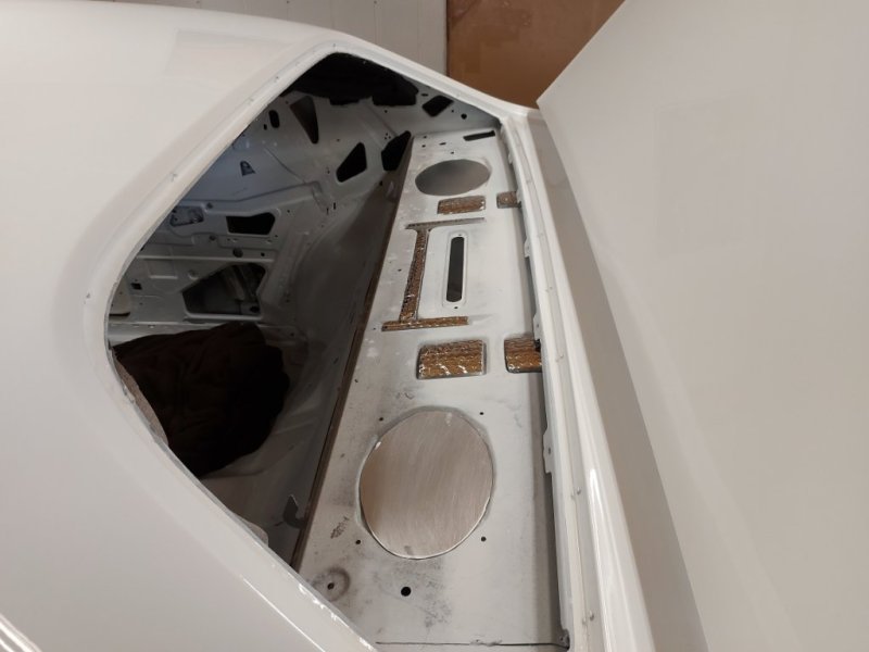

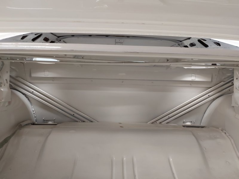

Can anyone post a pic of the trunk firewall installed? I need to install jaz fuel tank and battery in Plymouth -71 trunk. I'm going to leave the back seats in place. Street and strip car.
No pictures, but it is flat, maybe be 1/8” or so thick and goes right up against the chassis that supports the back seat upright

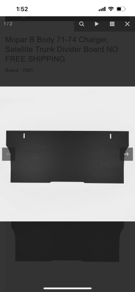

Trunk divider panel is what I believe is the proper name when searching

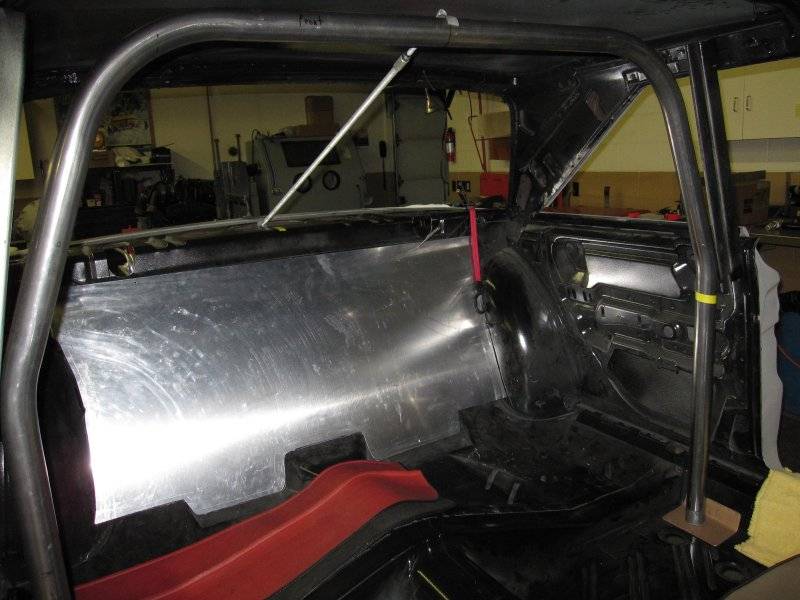

Mine is ,100" aluminum. I used #10 screws to retain it, with rivet nuts.

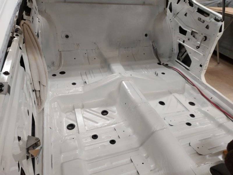

My Runners previous life was a drag car.
You can see the roll cage stubs where it was cut.

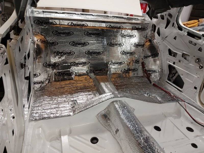

I left the divider in place as the battery is still in the trunk.
I did put some sound deadener on it.
