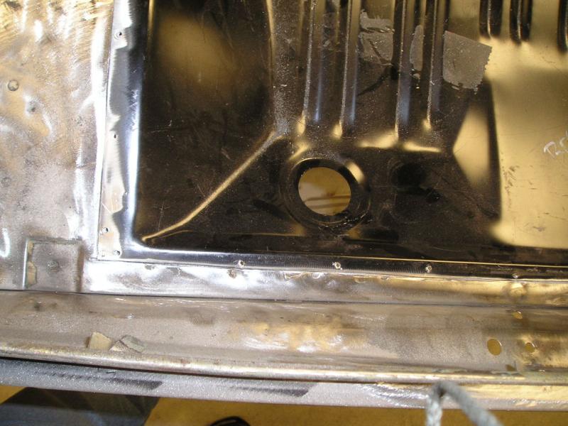

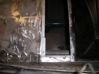

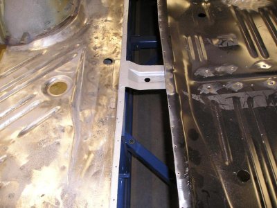

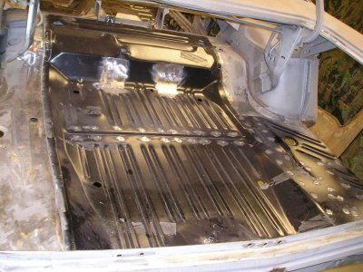

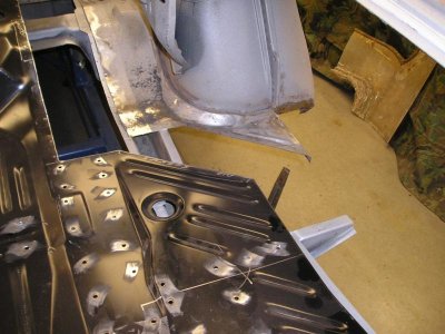

Keep in mind as well, just because you can get a full size pan, doesn't mean you have to use the whole thing. Pictured is the car I'm doing right now. The center of the pan and an area just to the right of it was shot. What I've done here is remove the old metal directly over the frame rail so I won't have to finish the weld on the bottom and there's no chance of blow through, as with a butt weld down the middle of a 2 piece.
You can buy a one piece floor pan and split it in three with the seams directly over the frame rails. Is this more work ? absolutely. But, it saves you from removing a quarter (or tailpiece) and eliminates the need to finish the weld on two sides.

nice work. How are you cutting the old floor out and not damaging things when it is goes right over the support rail? Did you just use a cut off wheel and were just very careful when you went over the braces?
Also, why do you have holes in both top and bottom pieces to be welded? I am very new to Mig welding but thought only the top overlapping piece would have the hole and would be welded to the solid bottom piece by filling that top hole with the weld.
How are you guys cutting your metal sheets like this in general. Scissors can curl it and can be hard to keep super straight. Automatic shears(I have) will cut very nice but take out a 1/4' piece as it cuts. A cut off wheel seems logical but seems like a lot of cutting for this way. How do you guys do it. e.g. if you wanted to cut the new full trunk floor piece into three pieces... how would you do it for the cleanest lines and least amount of waste?
I use a 1/16" cutoff wheel for the easiest cut and removal of the least amount of metal if I need both sides of a piece. If one side is being discarded, then I use an air nibbler. If you take your time, following a scribed line is not difficult.
The small holes you see in the frame rail and floor pan are for self tapping screws. These hold the floor down as I weld. When your all done, you just back the screws out and weld up the holes. At worst, you just have to touch up these spots from underneath.
As far as cutting out the existing floor without damaging the rails, I hog out the middle of the floor with a sawzall right at the edge of the framerail to buy room to work. Then I measure in about 3/8" and zip the upper layer of sheetmetal only. Next up is an air chisle the peel back the remnants and dress up the rails with a small grinding wheel.
