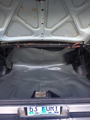

My car came with no trunk trim. I have bought both the cardboard trim, and rubber mat. From the attached photos, you can see they are close, but maybe not completely correct for this 63 SF convertible. So:
1. There is no cardboard panel to hide the trunk-seat space, in which the rain collector hangs. I might use the upturned part of the mat, as i tried to illustrate.
2. The purpose of the flat panel on the back of the side trim is not clear. It folds, and has a glue strip, covered, that will affix it...but to what?
3. Does the flat part of the bottom of the gray cardboard fold in, or out into the space at the side?
4. I plan to trim the mat to fit exactly at the sides, and put the trim over the edge of the mat.
5. I need 4 of the S shaped hangers for the side trim. I can't find any obvious place that they hang on, or into. Do they go over, or under, the trunk seal?
6. I already searched this forum, and looked at some well-appointed trunks, but none seemed standard.
Any help greatly appreciated, especially a source for the S hangars!

I just took the rear seat out from my '63 Polara in order to service the convertible top pump. The seat back (springs) exposed to the trunk area. I know that hardtops had a "cardboard divider" that hung on the seat hooks before mounting the seat. Did the convertibles also have something like that? Now's the time for me to take care of it. A picture or detailed description would really be appreciated.
Thanks
John
Yes I think there is a vertical cardboard panel. Why converter what comes out of the paint shop in one month, and I can’t see more than one I install my cardboard liners
