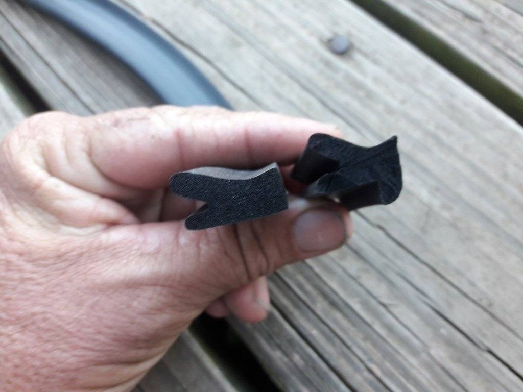

The trunk weatherstrip as pictured on the left is the generic style as used on the B-Bodies from 63 to 74. It can be used on all of the other models as well. The trunk weatherstrip pictured on the right is the correct style as used on the 63 to 70 model applications. This seal has the lip that extends over into the trunk area so as to locate the seal. If you should look at an original seal on a car, there will be an area where this lip was removed due to the metal lip of the trunk gutter. Back in the day, these seals were a molded piece unique to each application. The current seals are an extrusion and that is why it is no longer possible to have the lip molded correctly into the seal. It has to be manually removed to duplicate the factory original style as used back in the day.
Hello,can say me which kind of weatherstrip is it on the right side in your hand.
Thanks Christoph
