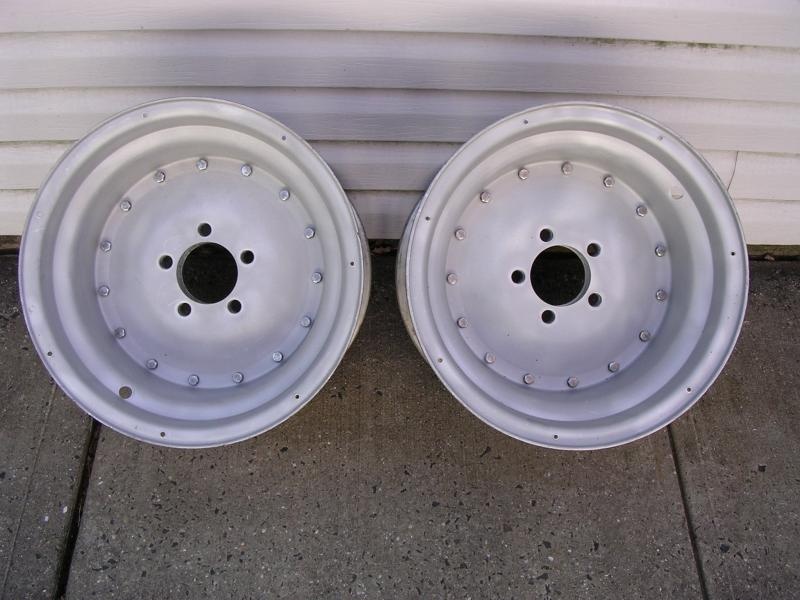

I am looking for 15x12 wheels with very little backspacing. 5 on 4.5. The rear end will be cut to fit the wheels and I am looking for a deep rim.
What is the lowest backspace I would expect on a 15x12? What should I be looking for?
I am having trouble finding what I am looking for. Especially Retail. I am looking for tips on where to find what I need and purchase them.
I am largely looking for something like a Cragar Super Trick (Polished). Like this :http://www.forabodiesonly.com/mopar/attachment.php?attachmentid=315809&stc=1&d=1333575691
Something that I think would also work would be these Polished Centerlines : http://www.forbbodiesonly.com/mopar...2)-15x12-Polished-Centerlines&highlight=15x12
Thanks!
Call Summit racing and ask about the Cragars. They will give you the Cragar tech line number and you can ask them what is the minimum backspacing they can make for you. You can order them through Summit once you get everything figured out.
Centerline offers their Auto Drag wheels in 15" x 12" with a 3-5/16" backspacing in both the polished and unpolished versions.
Part number for polished: 06 5123 545
Part number for unpolished: 05 5123 545
Unfortunately, I don't think Cragar offers the Super Trick wheels anymore. :(
