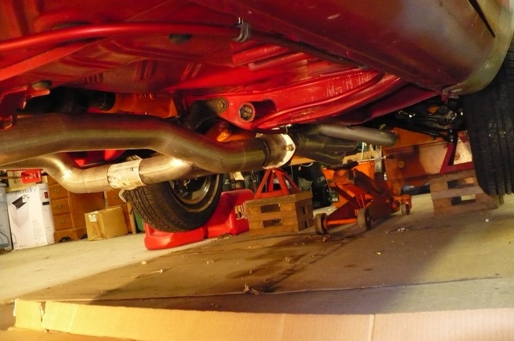

TTI 3" h pipe on my 65 Dodge 4 speed. Had to add a small pipe to connect h together because I didn't use TTI headers.
