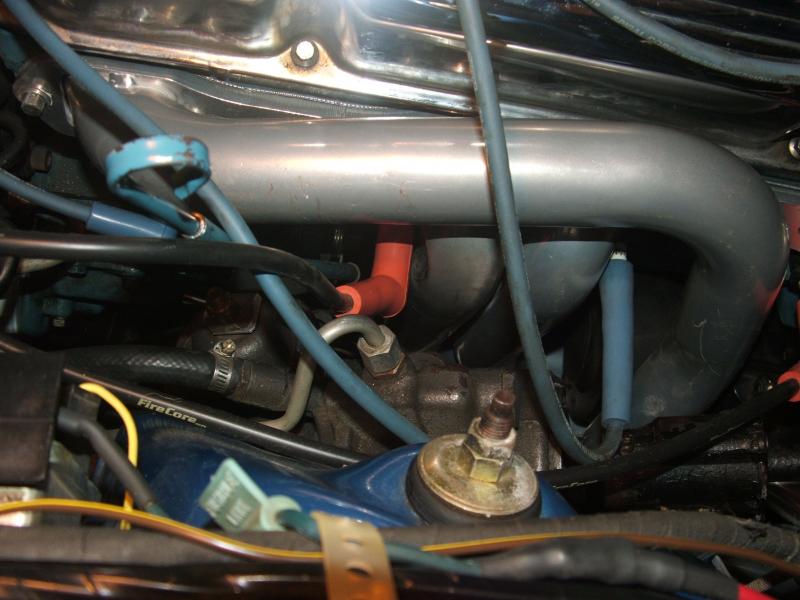

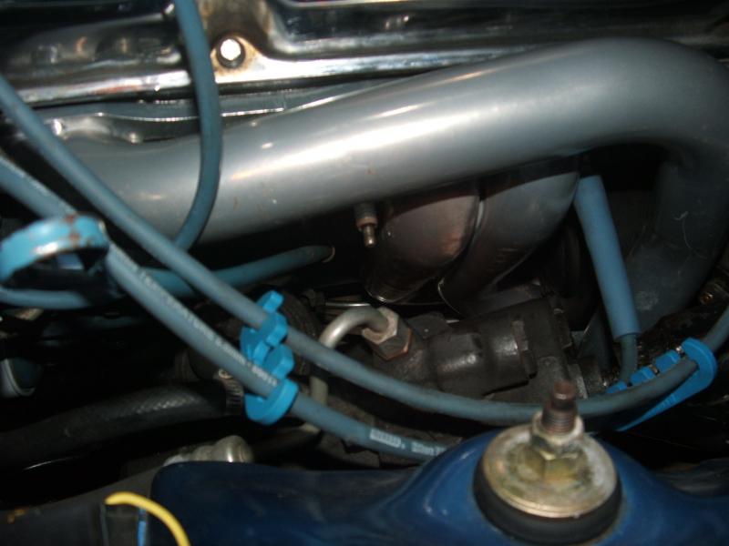

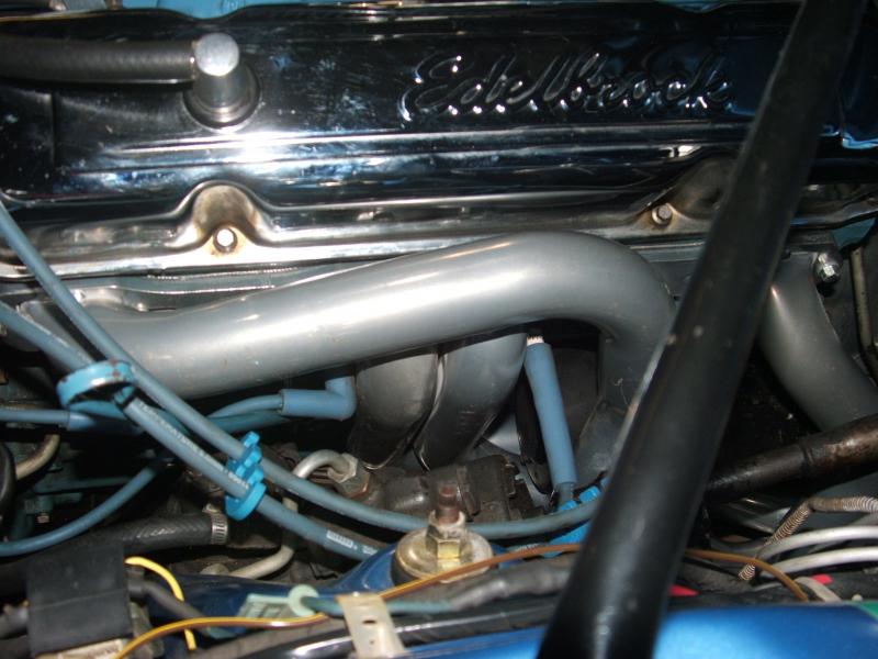

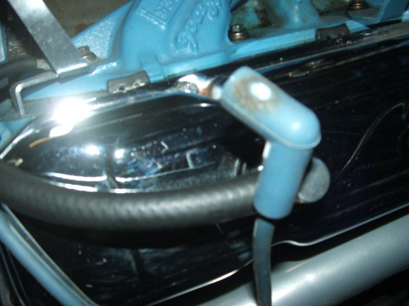

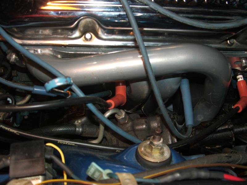

well,i have had my TTi headers hanging on the wall for 3 years,finally got around to putting them on,was excited,UNTIL i had to dent it by the idler arm for clearence,now i have this problem,my number 3 spark plug is right against the header tube,with the plug wire on its burning the wire.VERY DISAPPONITED WITH THE BEST HEADERS ON THE MARKET,AT LEAST PRICE WISE.so heres my solution,i am going to have to dent the tube for clearence,i cant even get a spark plug socket on the plug,have TO use a open end wrench to get it loose,i know the tube is welded all the way around the inside but just a few tacks on the outside,what should i use to dent it with,i dont need much,but if i brake the weld it will leak.ANY SUGGESTIONS HERES SOME PICS.

Yep, common problem with headers. That is really close. I would mark the header tube where the plug comes by it and remove the header. Heat the pipe with a torch (acetylene, butane, propane, etc.) until the tube is cherry red and then put a piece of pipe or a socket wall on the tube and hammer away. Like you said, the tube is internally welded to the flange and you hammering on it is not going to disturb it. You can buy a replacement silicone boot at pretty much any auto parts store that sells the silicone wires. It's a hassle, but it will keep it from happening again. Note that I had to do this on my TTIs as well:

i was hoping for a solution with header on,i have tried the boot insulator but it lays right on the header and still burns the boot

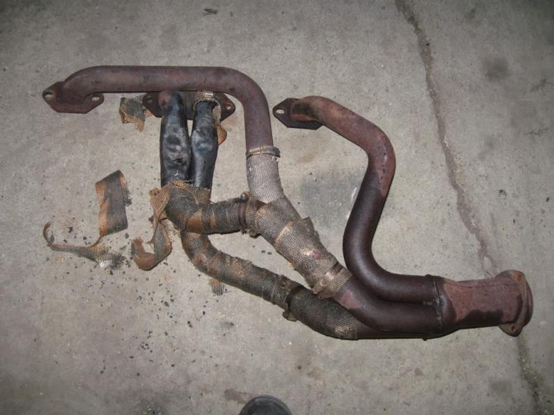

Stay away from the header wrap. The wrap holds moisture and will rust the tubes.

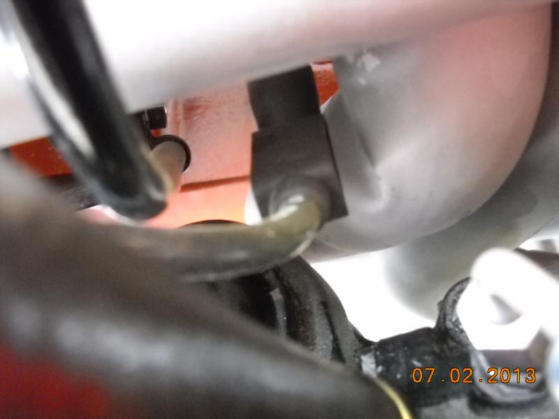

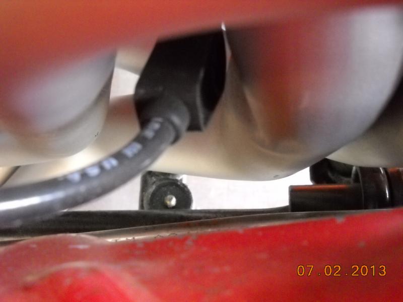

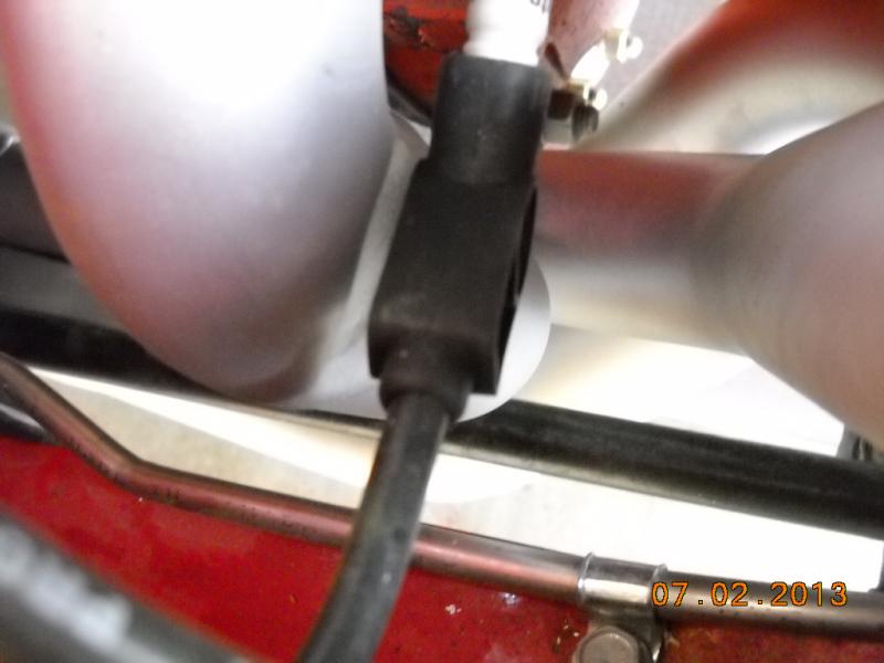

I have a 69 Coronet R/T with 2" TTI on a 440 with PS. I bought these in March 2013. Looks like they dent the tube near that plug now.

will be removing the battery and tray,to get a good angle on the tubehave some old hardend long sockets and will give it a couple wacks and see what happens ,i dont need.i also just got a set of firecore 50 wires and the boots are a little thicker so dont want to burn them up.thanks for the replys,will post some picks when i am done.
kb73rr over on the west side of the state.also no matter what boot i put on it,still lays on the header.cant even get a socket on the plug its soo tight.

they must have did a adjustment to those pipes to keep the wires off,thanks for the pics coloradodave.i must have an old set before they fixed the problem

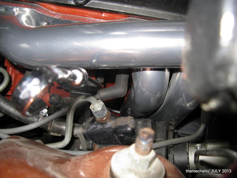

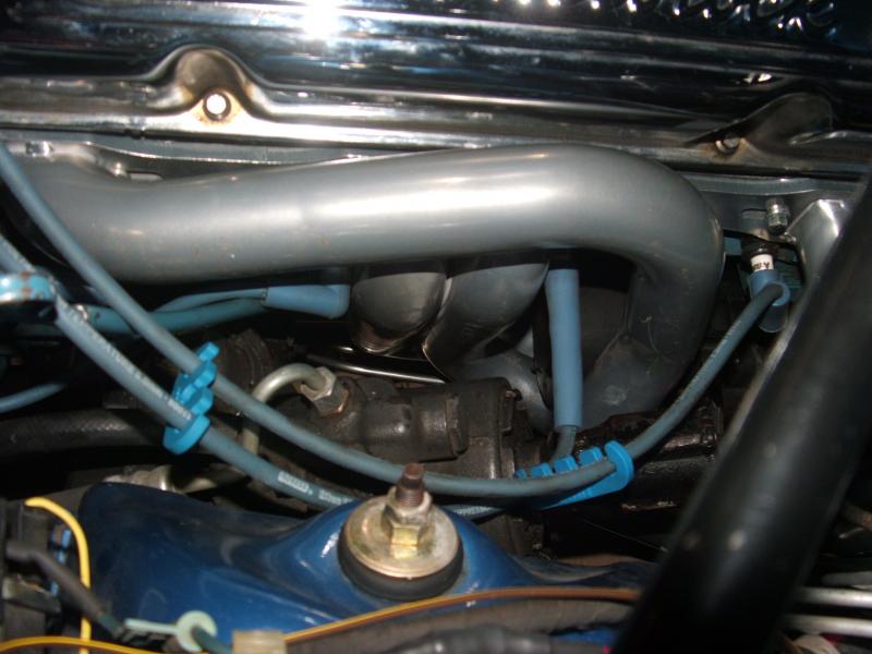

well heres the fix(dented)pipe with the new wires on,not hitting anymore.

Good job. I burned up several expensive boots from MSD and Accel before I pulled the header and did the same thing. Now I use Taylor 8mm with 45* boots on all the plugs. They do the job at about $56.00 and you can custom make the lengths.

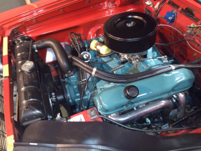

I have 2" TTI headers and use Firecore plug wires with Indy EZ heads. They have never burnt a wire at all. I used Taylor wires with 906 heads and Hedman headers on my old 440 and also never burnt a wire. But I highly reccomend the Firecore plug wires you see here on my eng. Ron
