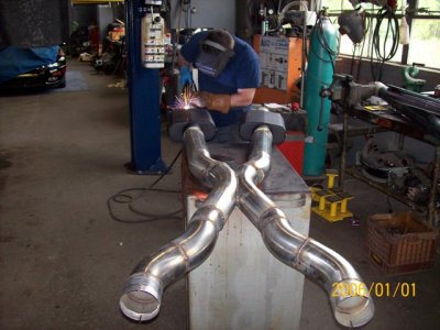

There's room for it,might be th angle of the dangle.Mine is TTI bur it is a 4inch.:glasses10:
My bad,just noticed and the edit option is not there:icon_rolleyes:
Mine IS NOT tti,but it is 4 inch:icon_bigsmurf:
