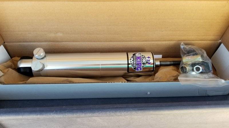

I apologize for the late question, but I am installing the 3 way adjustable CEE-2730 Competition Engineering rear shocks on my 70 Roadrunner tomorrow. Since they have to be removed to be adjusted, I would like suggestions on what setting to start at? I will have the Viking double adjustable 2 dial shocks on the front, and I can adjust them anytime. I figured I'd go 90/10 on the fronts at the track.
What setting to start with on the rears?
50/50 is my guess...
"The ratios for the rear shocks are 70/30, 60/40, and 50/50. These numbers represent the percentage of force required to extend (first number) and compress (second number) the shock."
Stock 440+6 Roadrunner rear leafs. Stock front suspension except for the Viking shocks. 315/35/17 Toyo Proxes TQ drag radials on 17" aluminum Rallye wheels. Standard transmission. 4:10 R&P
The adjustable pinion snubber is going on my Dana 60 tomorrow also.
Test and Tune night is Wednesday.
Thanks!
depends upon how good or bad your springs are, depends on how you have set your pinion snubber, and depends on how much front end you have to lift, and then depends on track prep for first 60'
so as your running stock springs, are they clamped on the front section, and have you removed the clamps on the rear?
the snubber needs to be 1/4'' from the floorpan
the front end needs to be around 1/2" to 3/4" off bumpstops
as your on stock springs id be as loose as possible so they can let the rear rise quickly then settle after launch, you will hopefully get lots of leaf separation on the rear section, and no wrapping on front.
hope this helps
Manual trans is tough with radials. Snubber close to the pan helped my 4 speed car. You need to hit them hard with rebound (loose) and keep them there with compression (tight). But with a tight clutch it'll hit them hard anyway. On yours I's start tight. On the front many times we see that 90/10 is too loose as the the front end comes up immediately, tops out and unloads the rear tire.

I'd start50/50
Doug
ahh sorry i didn't see your a manual trans, kinda changes a coupe of things as dvw says.
manual hits the tires hard, so you need gradual lift, so 50/50 is a good starting point
your front sway bar is also a limiter too, racers dont use them.
you will be fine, just start in the middle for everything inc the fronts and work from there.
Front Viking shocks sure are purrty...
Set the fronts for the 5 mile ride home to 7 and 3...very stiff!
Rears at 50/50
Raised the front end up by cranking up the torsion bars (because my garage driveway hump keeps hitting my cutouts, and it was (is?) an old-school Mopar trick....
So I definitely have to change the front settings before I drive an hour to the racetrack, then experiment with the front settings there for track conditions, focused on weight transfer and traction without "squirreling out" my steering at 100+mph
