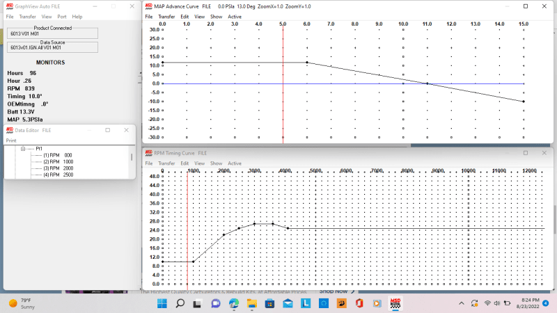

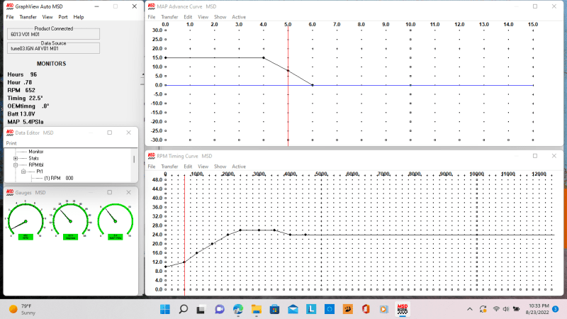

I’d like to examine your timing curves, both RPM and MAP.
I have a suspicion your MAP curve is not set up correctly and is pulling timing from your RPM curve.
I’ve added a pic of my timing curve - note there is nothing below the 0deg mark.
I have conflicting advice on this one. I did have my MAP sensor plugged in, and another guy with Hemi and a carb said it is not needed, and not used because it can't do anything to a carb'd engine? with no computer to add or subtract fuel etc.. and a post above says similar that on carb'd engines it messes with the adjustments on the carb?? so i am not sure here whats right or wrong.? i uhooked mine and it made zero difference in how it ran i can attest to that.

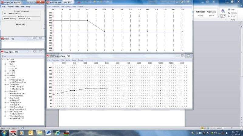

the last screen is where timing and MAP are.
