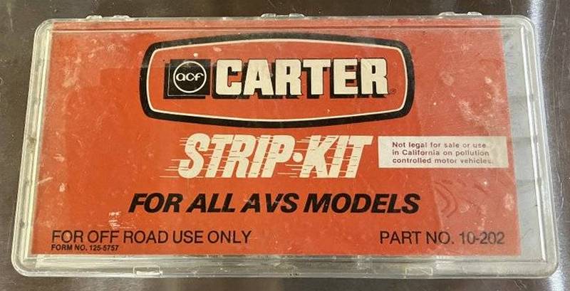

Yes Carter was producing strip kits for the AVS carb decades ago
And finding and buying Carter 10-202 TODAY is another
