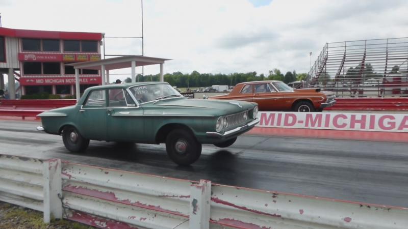

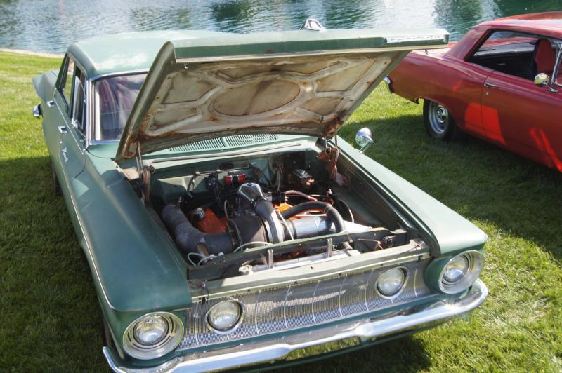

My son runs a nearly stock 360 in a 62 Plymouth. At 20psi it's been 10.08@136 with 275/60 drag radials and 3.23 gear @3700 lbs. Even at mild boost (12psi) it ran 10.60 with a 2.76 gear. Blow thru,E-85,stock manifolds,rods,crank.

Hey DVW, that is insane; I have checked out your sons car before online. Checking with a friend, who has an 8 second street turbo fox body mustang, he said my car even on as little as 10psi (76MM single turbo) could make around 700RWHP. I mean, it would actually be much better to toss out the 4.10 rear and run a 3.55 for interstate cruising. I may only be able to run 5-8psi as I don't want to grenade the transmission or bottom end. I am really seriously looking into doing this, I may piece it together over the next 12 months. I mean, if the little 'ricers' can toss a turbo setup together it would be an all out disgrace if we couldn't on this big block...
Hey DVW that's one of the best sleeper cars I have seen!!! I would love to drive that on the street & wait for some rice rocket teenager to make fun of it at a stop light. Love it.
OMG DVW!!!! That thing is hilarious! Ward Cleaver goes to the drags! What a sleeeeeeeeeeeper... THIS is what I'm talking about! Mega bonus points to your son.
Hey DVW, just gotta know what turbo did your son use? looks huge! Also is there a thread for his build?

76 mm S475 cheapie, $600 This thing on the street at 15 psi is a handfull. At 20 PSI it's down right spooky. At 12 psi I would bet it would stay together for a long long time. We have never run more than 23 degrees timing, at 20 PSI it only had 18 degrees total. No need for a 3.55, 3.23 is more than enough. Actually the 2.76 worked very well. This thing runs a .490 lift cam. No more than 5900-6000 rpm.
