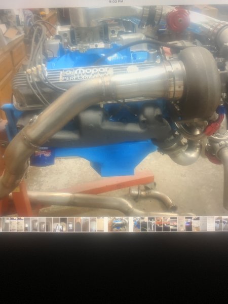

I’m wanting to do a turbo on my 360 magnum, so I need basic advice. Plus if you have any extra pieces laying around to start this project let me know. Please don’t ask what my goals are! Something like photo is what I’m looking to do.

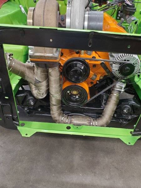

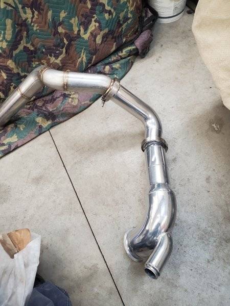

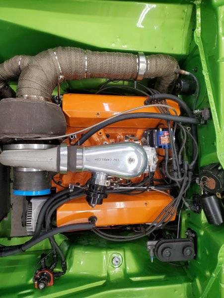

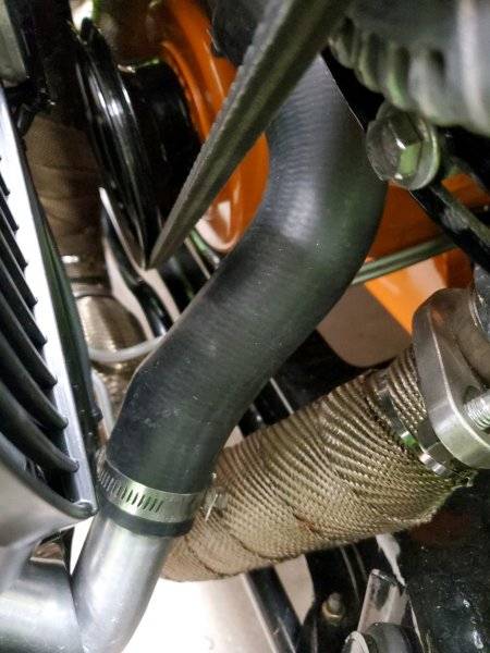

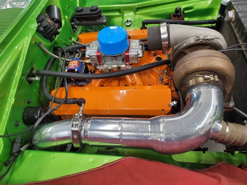

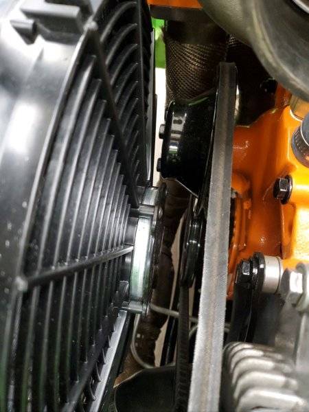

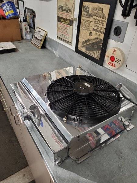

Last winter I swapped my sons 360 turbo out his 62 Savoy into a 70 Duster. It had been well sorted out in the 62. Ran a best of 9.55@142. Though I mounted the turbo in the same location it was quite a challenge to package it. Lots of layout and careful measuring to make all the pipes fit. Not to mention the radiator, fan, and radiator hoses. Had to reweld radiator necks, fab the fan and shroud. It was damn tight. Along with the wiring, fuel system, boost control. All said and done it turned out great. Been doing this kind of stuff a long time. It was a lot of work.

This is the info I need, what size turbo and size of engine? That set up looks real close to the pictures I have
This is the info I need, what size turbo and size of engine? That set up looks real close to the pictures I have 76 mm turbo with a billet wheel. 91 hyd roller LA 360. Stock crank and block.
76 mm turbo with a billet wheel. 1991 360 LA hyd roller motor. 1 7/8" truck manifolds plenty big enough to make over 850hp.
