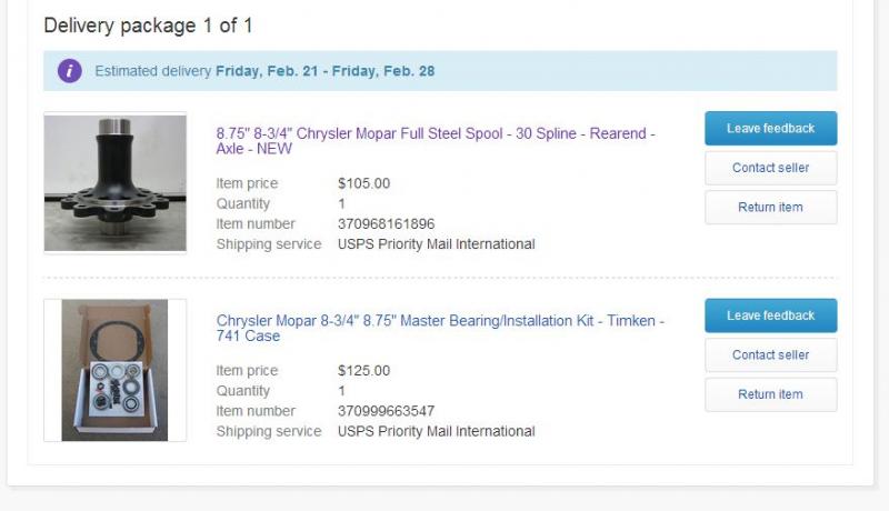

Ordered these tonight, no one wheel peels for this guy

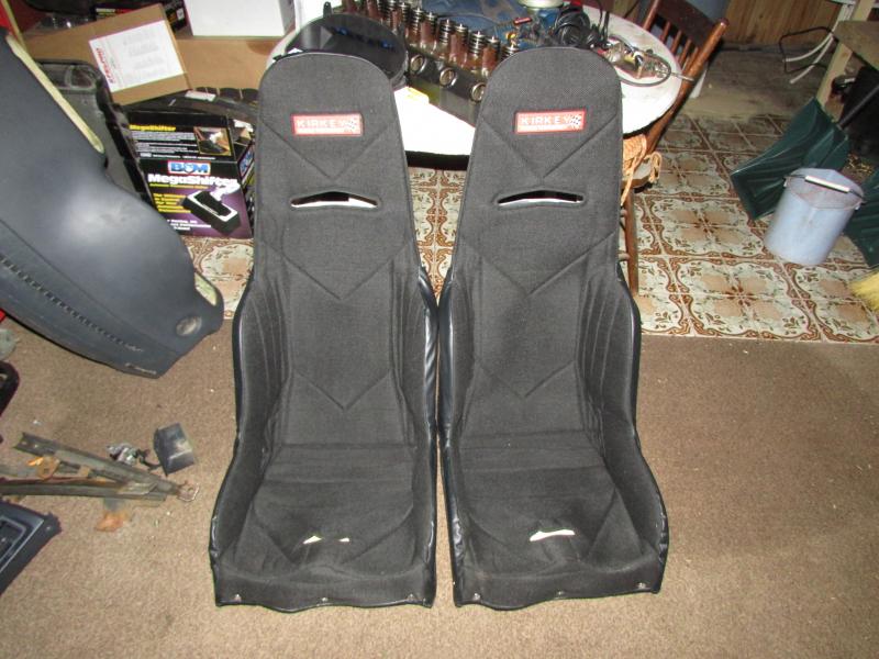

Picked these up for the car today, just slowly picking away at buying the stuff I need.
