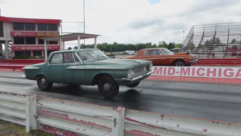

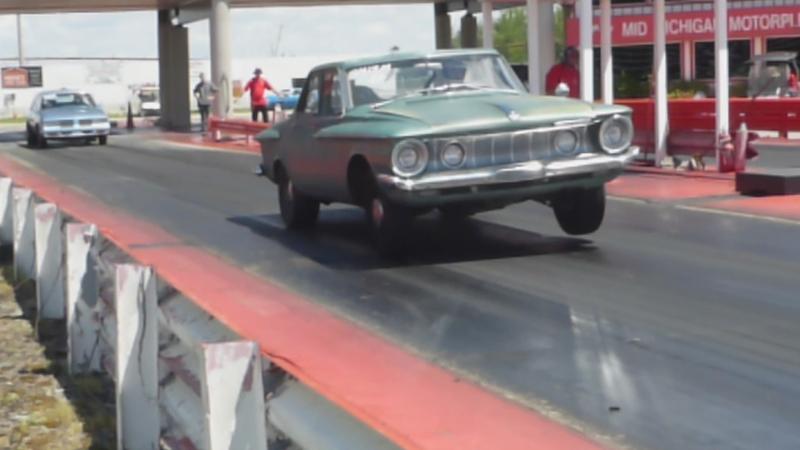

The turbo itself is the cheap part. it's the rest that gets you. Boost control,waste gate,fuel system,plumbing. My son did his 360 on the cheap. Still a fair amount of money. Junkyard turbos seldom are the correct combo. Get the correct combo and look out. His 62 Savoy has been 10.58@128 with a 3.23 gear and 275 drag radials at only 12psi.
