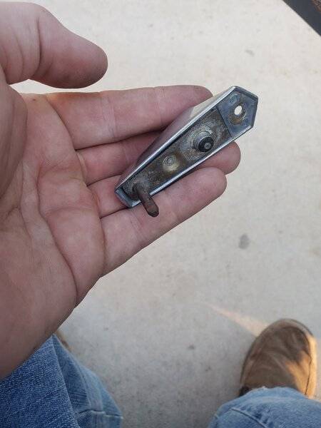

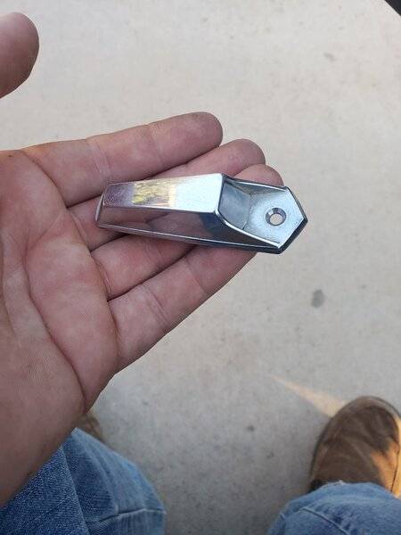

67 coronet with the hood mounted turn signal indicators. Right now one works fine, other is dead. Swapped housings and confirmed that the bulb is dead. I can't for the life of me figure out how to get the bulb out without damaging the lens or the housing.
Well nevermind. Its just a little 330 bulb and slides in. Well, its supposed to anyway.. this one was all crispy and didn't want to come out
Search the bulb on bulb shops... if you search on resto shop will find the price x20. As far I know the 330 bulb is not easy to come by on part shops.
Midget 330, I put led version in my hood signals.
I had some crusty fender bulbs too and I'm just gonna swap in LEDs like 440 suggested.
I ended up ordering and installing some led bulbs in them. They work really bright, now my only problem is getting the ground right on the driver's side one
The ground should be through the socket. If that's in bad shape you'll have to run a separate ground.
