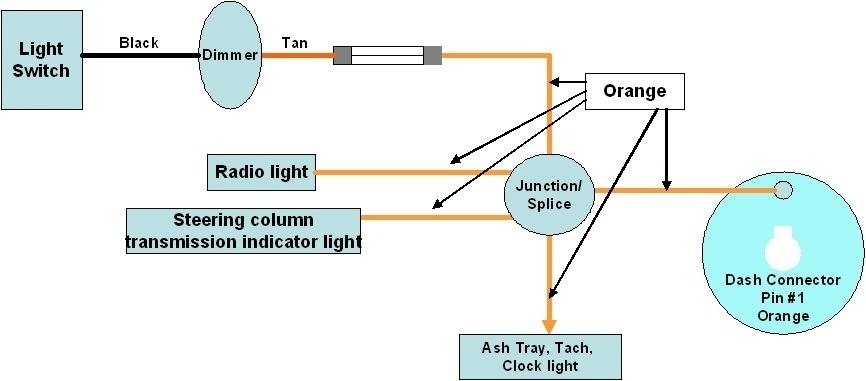

I have found alot of corrosion issues on the hazard switch and dimmer switch and some other corrosion issues. Once I wiggled the hazard swithch they came on. I am taking the entire cluster and switch panel out for a complete clean/inspection. The one thing I did notice is I had 12 volts across all of the fuses except the instument fuse which makes sense because i had no instrument lights. I do have 12 v at both hazard and turn signal relays so again its going to be conn issues. Again I think this is a bad connection. Thanks for the help
The one thing I did notice is I had 12 volts across all of the fuses except the instument fuse which makes sense because i had no instrument lights. Thanks for the help
The 12V at the fuse is fed from the light switch (black), via the dimmer switch (tan) to one side of the fuse. The other side of the fuse is an orange wire. The orange wire feeds the dash, radio light, gear selector indicator, etc. Even with no dash you should have 12V at the fuse with the light switch on and the dimmer switch in the highest on position.
