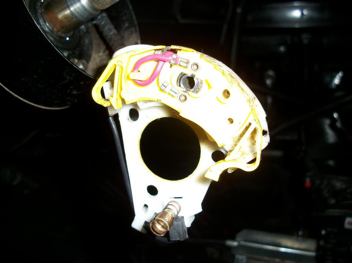

I have a 66 Satellite with a turn signal switch out of a 67. The cam has been filed away so that the turn signal switch operates but the cancellation tab on the bottom of the cam has broken off. So I must manually turn off my right blinker. I see that there is replacement cams available for the 66 turn signal switch. I need to find out if I can replace the cam on my 67 turn signal switch with the cam for a 66 turn signal switch. Or is the frame of the 67 turn signal switch larger than the frame of a 66 turn signal switch meaning that it still won't work? The 66 turn signal cam can be ordered online for under 20 dollars, but a brand new 66 turn signal switch is over 150 dollars. I would like to just get a 66 turn signal switch if it wasn't so expensive.

They should be almost the same...I have the same thing going on with my car...One of these days i,ll get to that..
Petty Blue 67 gTx
I am using a 1967 switch in my 1966. You just have to use a dremmel tool to grind a bit off the plastic.
