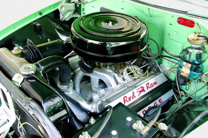

Ultra Rare small block 440 in Arizona
An ultra rare small block 440 with Gen 1 Hemi heads too... meh, I've got several of those already :jerk:

Designed to compete against the Ford Boss 302 and the Chevy Z-28 Camaro in the Trans-Am series during the late 60s and early 70s until Chrysler developed the 340!
Only a few of them built.....

Looks like an early 50's desoto Gen 1 hemi. Good luck finding parts for that!
Well, it IS a hemi.....

Spoon fed/force fed chevy doctrine = small block/big block 400 MUST be = small block/big block 440.
Pretty sure thats an old Hemi from the 50s. Think they came in the De Soto. Maybe a 354?

With the short bell housing, it must be 1954 or later. It looks like a Desoto, but is not 354 due to the heads not having the ports for water. My first guess - without seeing any further - is either a 276 or a 291 FireDome. Yes, a Hemi, but virtually no parts are available. And NO, the Chrysler 331, 354 or 392 parts will NOT interchange.

Ask him what are the numbers on the front of the pan rails...that will tell us what we need to know and decipher this engine. Simple as that.
