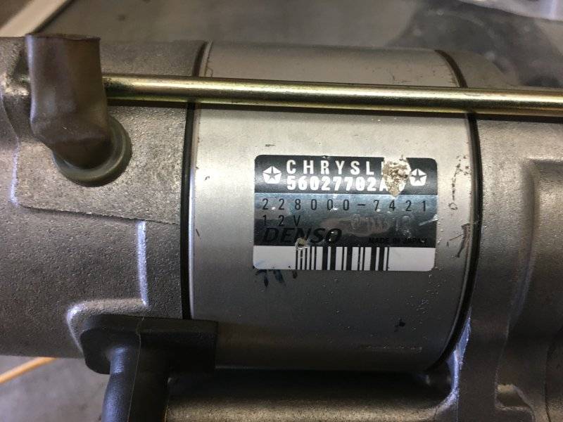

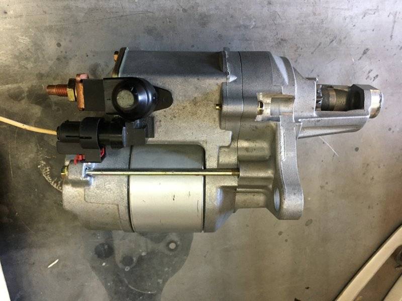

There's a reason so many of us run one of those starters - among them, the ease of finding a replacement if
need be (buy a rebuilt one from one of the big box stores and get a lifetime warranty!).
If the post was a problem, it'd be infamous for that.
It isn't, with a bit of common sense applied like KK says above.
Mine has been through more than one engine and 13 years with the car so far. Tough as nails.

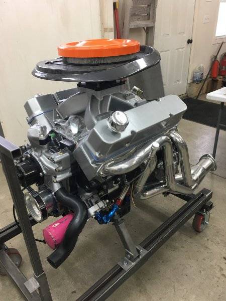

Just be aware that some of the old headers won't work with a mini starter. My ancient hookers have a tube that runs through the space that a mini needs. I'm stuck with the ancient 100 lb gear reduction Mopar starter.
I feel for you. I had to dimple my header and grind a little off the starter
