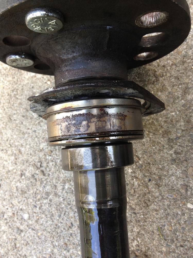

I pulled my axle shafts today and found that I have 2 different length axle shafts...It's a 68 super bee, 8 3/4, 742 casting. Originally a 3.23 rear (now 3.73), one shaft is maybe 1/4 inch+ longer than the other. Was this to compensate for the offset pinion in the 3rd member, or maybe the bearing adjustment? Or is it some used junk somebody threw in between 1968 and now? One is tapered a little different than the other, and one has 2 smaller holes in the flange w one big hole, and the other just has the one hole in the flange. Both are 30 spline and fit in ok.

This is the odd shaft w 3 holes (not counting the lug stud holes) on the axle flange before I changed the bearings
With the NON adjustable bearings you have, the axle shafts do NOT have to be the same length. The stock setup required them to be the same length because they both pressed against the thrust button in the differential and the right side adjuster was responsible for the end play. With the NON adjustable bearings, the splined end of the axles dont even have to contact the thrust button at all.
Could one of the axles been cut to shorten when the greens were put on? Apparently a common thing to do instead of pulling the 3rd member out to remove the thrust button.
Take a look at the axle ends and if they look different, then one has been cut.
