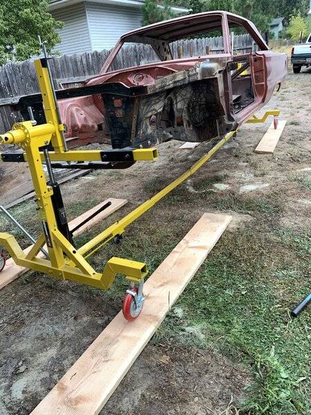

Not a 62, but a 67gtx. Unibody also.

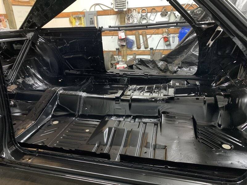

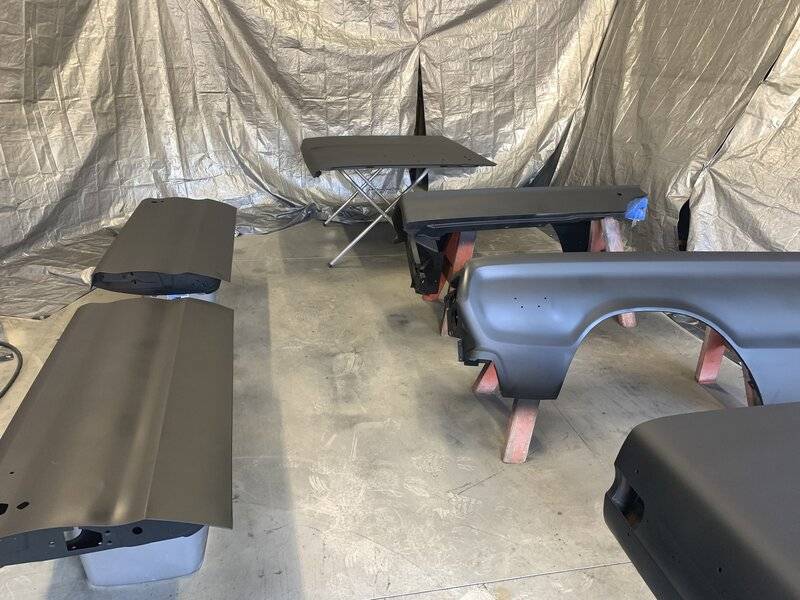

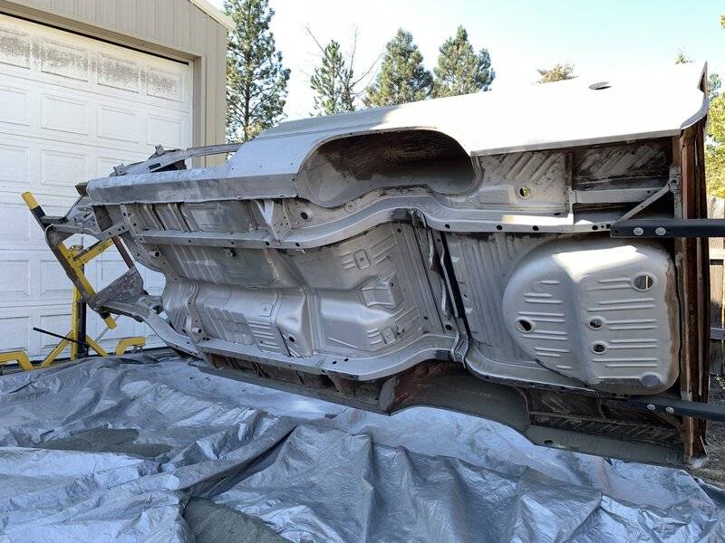

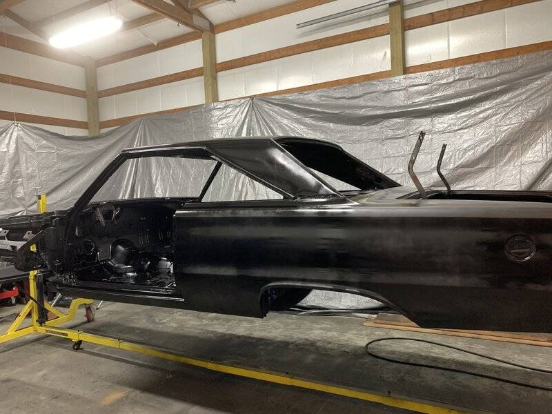

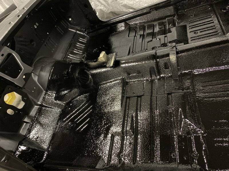

Here’s what I did. I did a rotisserie sandblast with medium crushed glass, fixed all the rusted spots, sprayed it with rust encapsulator, skim coat of body filler where needed, then a coat of epoxy primer. I used truck bed liner for the interior floor and under coating.
I’m not done but here’s some progress shots. This is my first build, and I’m learning with you.
And I added frame connectors.

I am using Harbor freight jackstands and 2x4s on a gravel driveway...

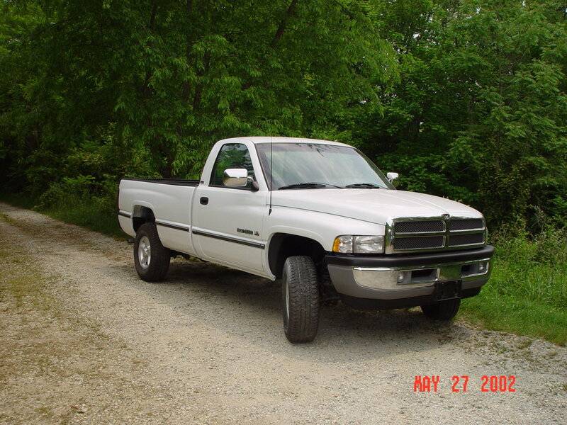

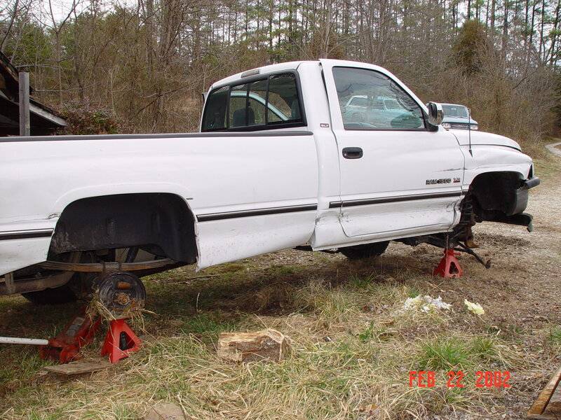

We work with what we have. I started the same way. Whatever body work was done that day had to painted in case it rained. I turned out some great work and I'm sure you will too. Just a couple of pic's from one of my projects.
