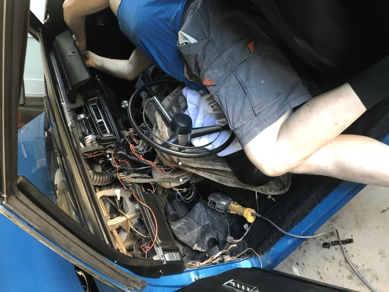

Just got the car of my dreams but like everything there is a little worm in the apple. Seller told me the speedo cable was disconnected so sounds like an easy fix, right? Discovered the speedo was loose in the dash, none of the dash lights worked, the dimmer switch wiggled and the headlight doors don't work. So here we go.

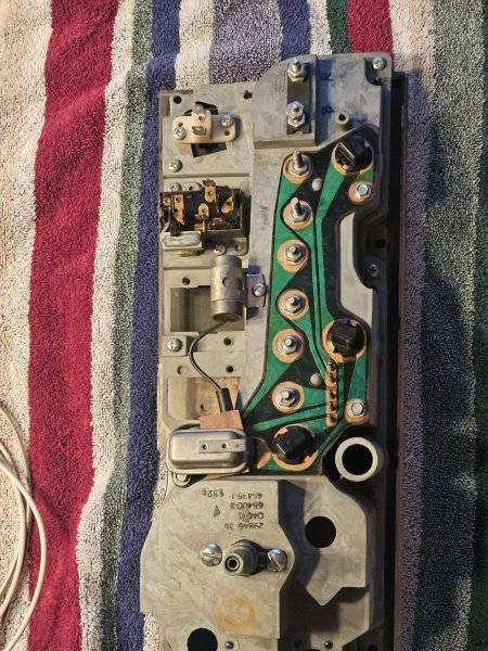

Found out the speedo was loose because there was only 1 screw and it was cross threaded. Dash lights didn't work because 2 were missing and 1 was burned out. Dimmer switch was wiggling because 1 screw wouldn't titen.
Resized_20241104_071745_1730746934367.jpegResized_20241104_071754_1730746952935.jpegResized_20241104_071800_1730746955681.jpeg

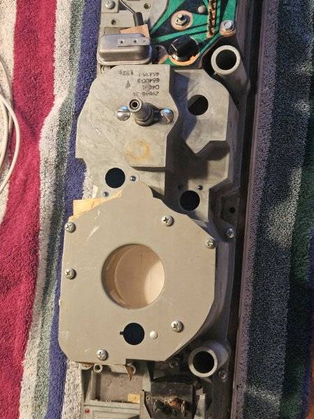

Dug through my box of misc fasteners and found the correct screws and un cross threaded the hole. Incidently tested the speedo and it works fine, so why was he trying to take it out?

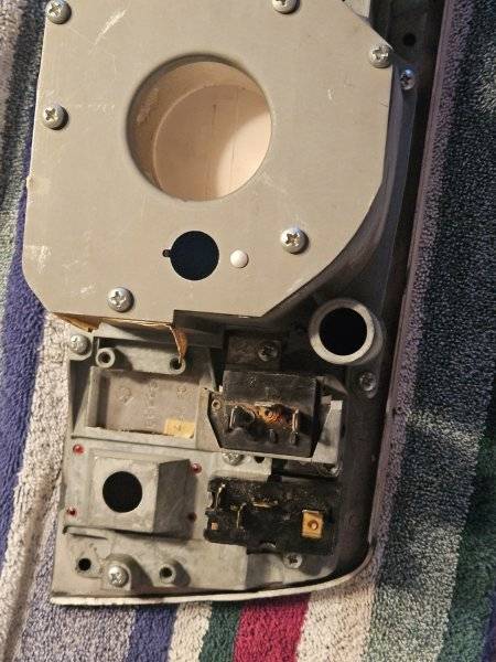

Found the dimmer swichc was pretty badly corroded and hit it with some contact cleaner. Afterwards the resistance was smooth and linear so I think I ok there.
