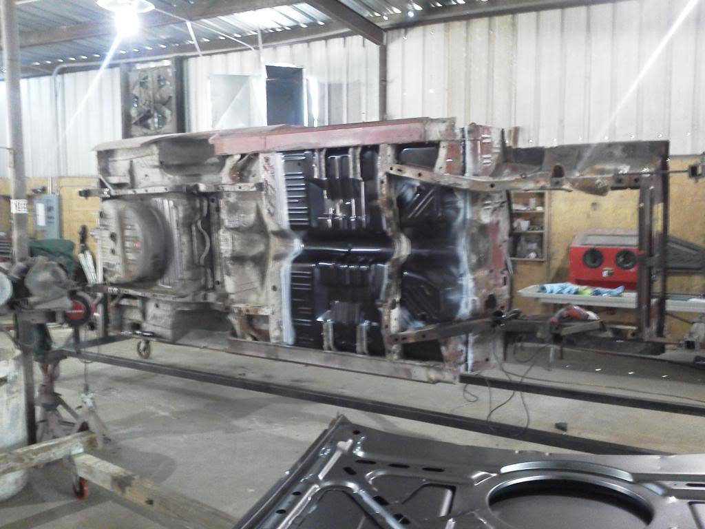

This is a beautiful sight to behold!!! Removing the undercoating, adding additional welding and trying to decide whether to spray bed liner or undercoating. Needle scaler is doing wonders as well as a thick putty knife and hammer. At 49 years old, this is a lot easier than laying on my back!!

Looking really good, I liked the spray on beadliner that I used on mine (Xtreme Liner) but wanted to warn you to mask everything off. Unlike paint if it is sprayed threw a hole like your shifter it doesn't dry before hitting the next object it goes all the way across the room and still sticks to what it hits (messy). I do really like it though, it looks nice and is really durable against scratching and even helps seal the bottom up.
