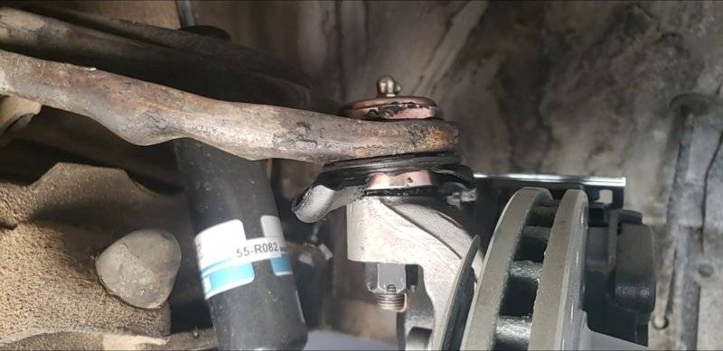

Here's a pic. Both sides did exact same thing.
Are those factory spindles? Looks like the spindle is in contact with the ball joint and tore it.
69L48Z27, no, they are aftermarket for disc brakes. That is what it looks like to me also. I may have to get ahold of company I got disc brake kit from. Unfortunately I have no reference if the spindles are correct or not.

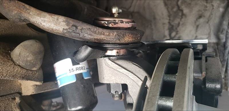

Ok, doing some thinking during the night. The disc brake conversion is a DrDiff 11.75" stage 2. I'm thinking that because the suspension has been hanging for over a year, on jackstands, that the droop caused the dust boot to get pinched. That if it were on the ground, it would not be pinched. Anyone have any other ideas?
Here's a pic of the suspension jacked up to normal ride height. "Looks" like it would not pinch.
