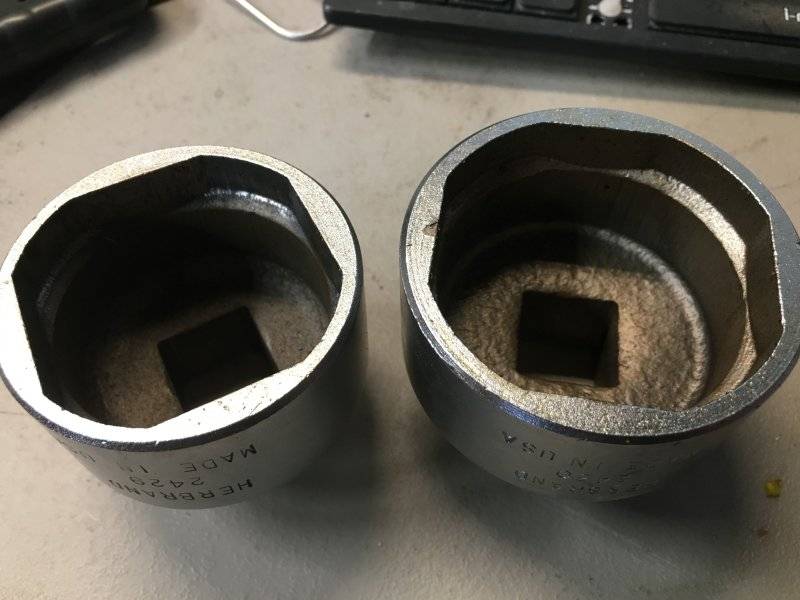

I think there might be three sizes, A,B and C Body. Rented a socket set from Advance so hopefully I’ll get these changed tomorrow. Soaking the joints tonight with penetrating oil..
A&B should be the same as I have used the smaller one on My 73 Duster and the 68 R/R. Picked them both up at a swap meet because why not?
