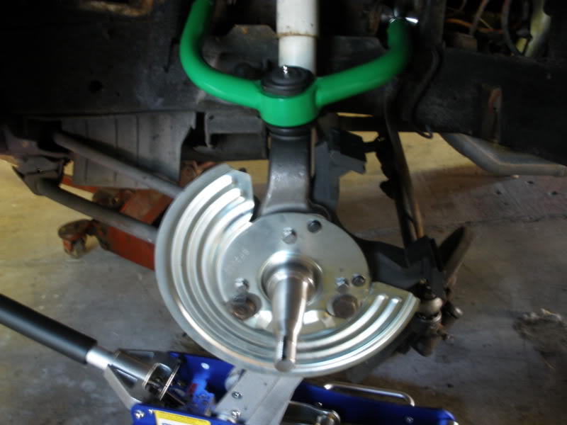

I used Firm Feel tubular UCA to gain positive caster-fit like OE and worked out great with almost 4 degrees positive caster. Had a couple questions and Dick @ Firm Feel was very helpful and friendly!
