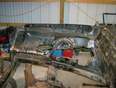

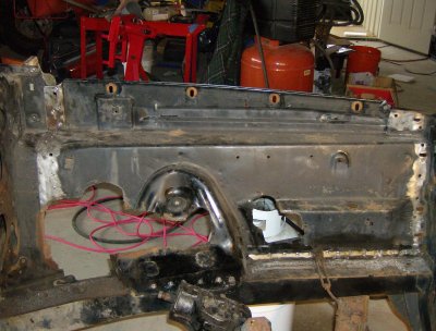

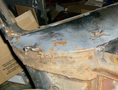

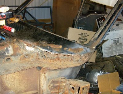

I have just removed my upper cowl. Some bad some good, although when I look at the pictures it looks worse than it is.
I have outlined the areas needing replacement with white.
I have secured a very good replacement cowl from the south. I feel pretty lucky. Hopefully it fits well :edgy:
I am going to blast this area next week and will have a better look.
I certainly have some panels to make and I am no expert.... actually beginner....
I had an idea..... for example.... the areas I have in white outline in the pictures have varying slopes and rises etc... for me to make these exact with no experience will be a challenge.....
What if I took wax paper and taped it off in these areas and then layed down fiberglass or (any ideas for something else) and made a pattern. Then peeled it and the paper off the metal, put this pattern in a mound of sand and had a piece of replacement metal and started to pound out the pattern ? No one will ever see it under the upper cowl, so close should be good enough :confused:
Could it work ?
Any other ideas, I live remote and don't have a lot of panel makers in my area ?
