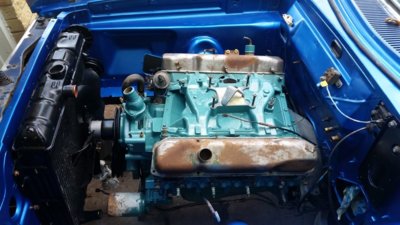

Not sure if my setup is the same as yours, Here's the best pic I have.
