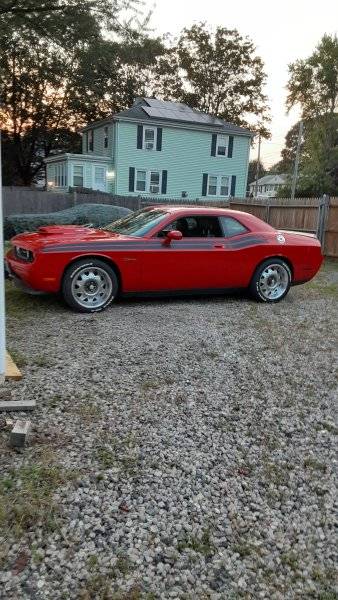

I paid 20k for my 2010 Challenger R/T 5.7 6 speed, with 18k miles on it. You would be better off to get something like that,this is essentially a brand new car,for 20k.
