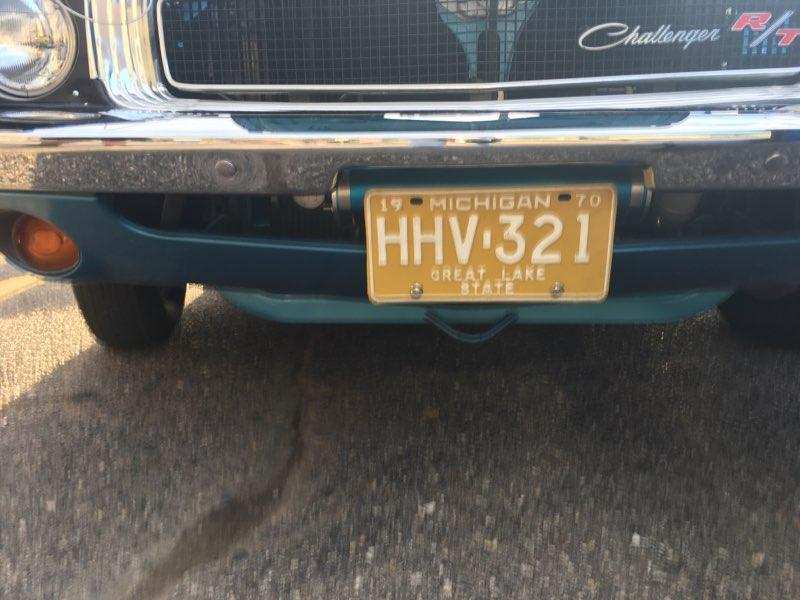

Yes, I like mine. It wasn't too bad price wise. They are just hideous looking where most people mount them. I hid mine behind the front bumper. Can hardly even see it.

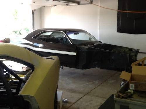

Looks like a challenger, just like mine, ha! Was gonna put it in the trunk, but sure makes for a realllllly long run & even more oil. Behind front bumper was a great idea being still close to engine compartment.
My project’s still not done……it started in MI before i retired down to SC in 2015 and been only 13 years since i first bought it as a roller.
