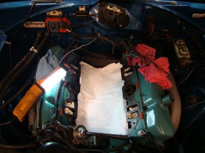

i just put a bit of ultra black gasket maker in the corners for a little insurance, and no leaks!
