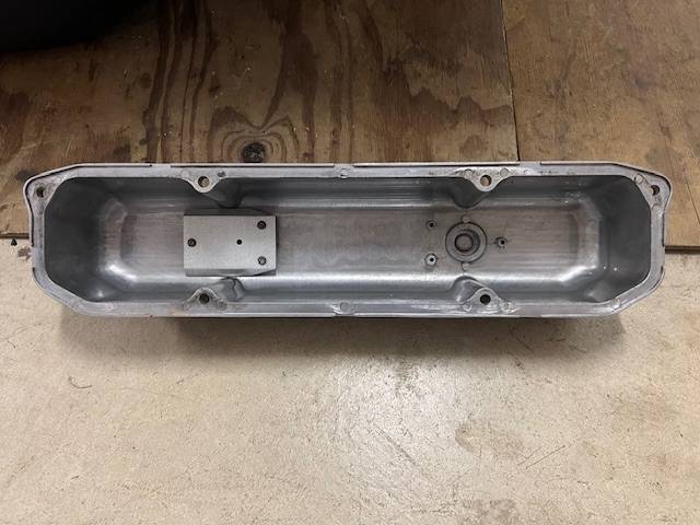

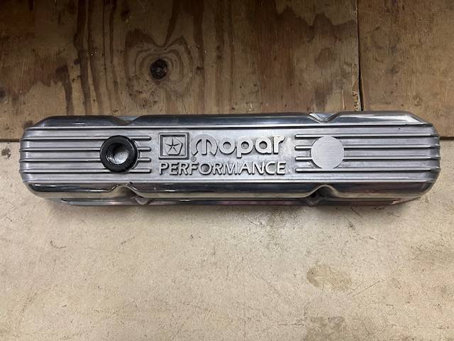

Mopar Hunter: I was considering the Moroso 93055 or the Fel-Pro 1610 gaskets for my 440 that I have Mopar Performance cast aluminum valve covers on. The problem I have is that the Fel-Pro's currently on the vehicle are leaking (they are FEL part number VS50145R, also rubber) and the Moroso's seem like they are also rubber but, a lot more expensive. Any thoughts? What type of gasket sealer do you suggest for the Fel-Pro's in your message above? I'm not interested in reuse of the gaskets.
Cast covers on original (well, big blocks anyway) heads
can be troublesome, cause the original threads are NOT perpendicular to the gasket surface. Aftermarket aluminum heads are perpendicular.
Another reason the "manufactured" covers that use long bolts are difficult to use on stock heads.

Thanks for the info. You mention "four bolt gaskets" but, my VC's are 6 bolt. See the pic I've added. Maybe I mis-spoke in my original message to you.
The issue, as I understand it, is that the cast edge on the cylinder head is essentially rounded at the corners making it difficult to get a good long lasting seal. That's why I though some type of Permatex or other gasket sealer in addition to the gasket might be a good idea, realizing it would be very difficult to get off later. However, if it stops the leaking I think I'd be okay with that. Your thoughts on the use of a Permatex or other sealer??

There was a period a while back where the corner bolts on the Mopar Performance covers would crack the cover if tightened too much or out of sequence. Be aware.
I tend to use pretty much any gasket sealer or silicone on the cover, just to hold the gasket in place, and give me an opportunity to maybe re-use the gaskets after running the solid lifters. A little oil on the head side of the gasket helps too.
