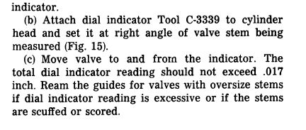

The FSM does discuss guides.
What are you doing for machining? Guide work is quite fussy and valve seats will need to be ground to ensure concentricity.

Thank you all for the replies. Got it. No guides to bang out. Check side play, if too much off to the machine shop and get bigger shaft valves. At the moment I am in take it apart mode. About 50,000 miles. 318 was running good. But need a bit more power. Camper van weighs 6600 loaded.

THis is the normal way to test, 2 methods shown.
Interesting test here. Never used it. But if it doesn't pass this test? My bet is the guides are pretty bad.

I did the wiggle test, interesting way to measure. But the results are in. Point 25mm. Wonderful. Above we learned that 17 thousands was the wiggle test. I think we have point 009843, which is less than 17 thou. So, I will clean the heads, and lap the seats by hand. They look good enough to do this.

Just looked at the videos above. The suction test is interesting. But I checked the wiggle with a dial gauge.
