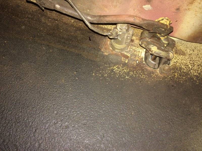

Too thick, the panel likely won't fit properly. Also, that stuff sticks like snot. If you have to get inside the door you'll have to cut the access holes out. Personally I'm liking the idea of spray-on sound deadener. And FWIW, the factory did spray **** in there, here's proof:

Ok, if it's very thick then your door panels will stick out, and you still need a vapor barrier. I don't know how thick it is. You asked for opinions and now your trying to argue about it. It's your car do what you want. I was just trying to offer something.
