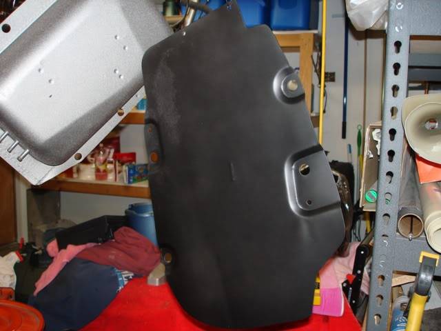

Apologies, I should of said tank, not can. Its supposed to have one behind the rear drivers wheel bolted in, it has 4 vent lines on it that match to the 4 vent tubes coming off the fuel tank. I think it was mid to late 72 that the charcoal vapor cans in the engine comp were in use but 71 wasn't used.
They look like this.....
'70 California plus '71 50-state/Canada B-bodies. A-body's not the same. Neither is E-body.
Or install a '72+ tank (thus eliminating the separator you're missing) and install a cannister + purge valve per above link.
