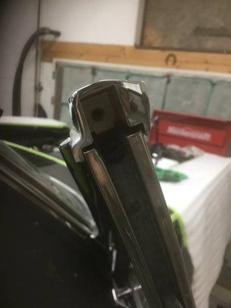

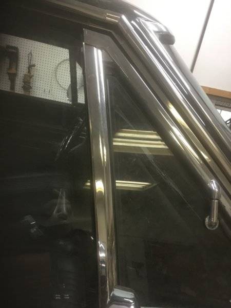

I got a set from tonys. They look good but , like any aftermarket part not exactly the same, (note the top triangle area in the first pic) Fit was good, chrome looks good, but the screw holes where the rubber seal goes at the top of the post is drilled and tapped the wrong size. They are reversed. Don’t forget to order the epoxy he recommends. If you can save your old window rubbers do it. The repo ones I used suck.
