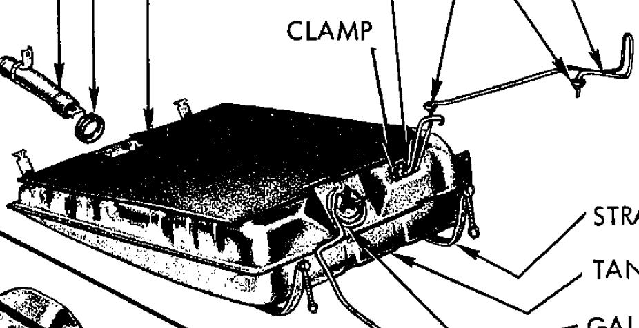

The diagram below is cropped too much, but the vent line is in the upper right. The 3rd arrow from the right is where it comes through the floor of the trunk. It makes the loop (far right arrow) in the trunk and then vents to the atmosphere where it exits the trunk (middle arrow). I suspect yours is similar if not identical.
