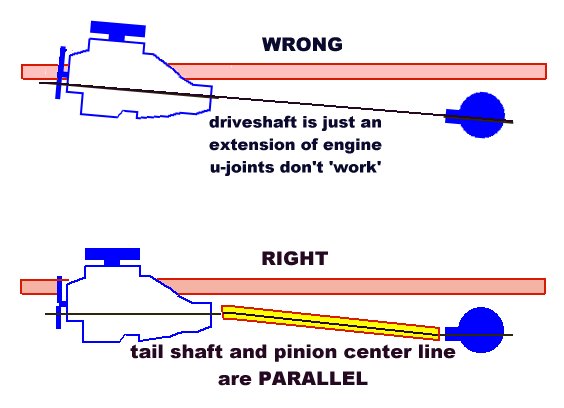

So with that in mind i started looking round for a copy of a diagram I saw years ago, showing the ideal pinion angle in relation to the transmission, and came across this...
http://jniolon.clubfte.com/drivelinephasing/drivelinephasing.html
Yes it refers mainly to off-road/4x4 type vehicles but I'm sure that diagram is the one I've seen before (see below)
This says the ideal angle should be 0°, (or 180, depending how you add it up!).
Sure, you can have a few degrees between the tailshaft and the front end of the driveshaft (tho it doesnt say how many), and the same between the back end of the driveshaft and the pinion, but the tailshaft & the pinion must be parallel (but offset) to eliminate vibration. According to that link anyway.
Wedgie, could it be that your 3° is the angle between the pinion & the driveshaft rather than the pinion and the crankshaft? :icon_scratch:

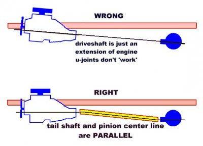

Think we might be getting somewhere...
I just read elsewhere that the tailshaft & pinion should be parallel, but that's under driving conditions.
To achieve this, you need to set the pinion so it's facing downwards in relation to the tailshaft by 2 or 3 degrees, then, once youre on the move and the rear springs have wound up a little from the torque, it will put the pinion & tailshaft parallel as shown in the diagram above.
Does that make more sense? :eusa_eh:
As I understand it the drive line can only tolerate misalignment in one direction. The above "correct" drawing assumes you have no misalignment as viewed from the rear. If you have misalignment in two planes then the weld yokes will need to be out of phase. Early Camaros and Firebirds have exactly that situation where the rear end yoke is up and over as compared to the tranny yoke so an in phase shaft won't work. I found all this out when I had a 68 Firebird drive shaft in a 69 RR with a Dana 60. By pure luck (or not) the length happens to be the same as a B body / Dana 60 combo and uses the 7290 U joints.
I helped a buddy install a 9" Ford rear end in a 50's Chevy truck and the pinion on the 9" was offset to one side relative to the tail shaft as viewed from the rear. The tail shaft was pointing down and drew a straight line to the pinion CL as in the "wrong" diagram. I was going to nose the pinion down, but remembering my prior experience, I decided to leave it pointing to the tail shaft and let the side to side misalignment take care of the "correct" drive line angle. It was the example of the "correct" drawing but turned 90 deg. The end result, as reported by the truck owner, was a smooth ride at highway speeds. I suppose there may have been an issue if the truck was loaded down enough to put that other component in the yoke alignment but the springs were pretty beefy so it didn't move much. The correct way to do the swap would have been to make the pinion in line as viewed from the rear and make the misalignment in the vertical plane. Hope this shades some more light on the situation.
