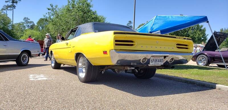

I ordered up some Viking Crusader triple adjustable shocks since my single adjustable fronts are shot and my double adjustable rears seem to not have the right valving.
http://vi-king.com/media/wysiwyg/VIKING_APPGUIDE_1218.pdf
I ordered 2-Front C617RK-W with 2 Front Springs 10DP400, and 2-Rear shocks, B617HM
We’ve been trying to get the chassis to work in order to hold some boost at the launch. Tried everything, less timing, switch to a looser converter, but could only muster a 1.43 60’. Chassis just won’t work with any power in it. Back to square one on the next outing.
