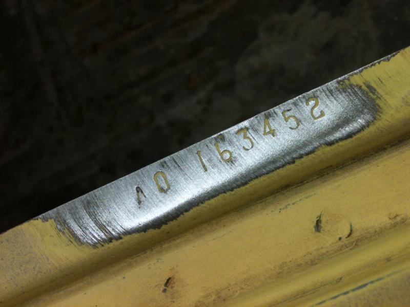

I've found the VIN on the trunk/quarter section but cant seem to find it on the front end of the car...any ideas? Thanks.
Vin location
I have a 1969 Roadrunner and my number stamping is on the top horizontal radiator support on the drivers side approx half way from the edge of the radiator from the battery side and the radiator neck .Just look at a 45 degree angle between the support and radiator..If the radiator was out you would see it very easy..Mine is approx 1" below the top..It took me a few times to find it ..My Vin RM23H9G...
G= St Louis and that is the typical location..Cars made in L.A. have the stamp right on top and is easy to find...When I was looking for mine my fingers were all dirty from working on the RR and rubbing my fingers across the numbers made them really stand out to see...Rick 70
