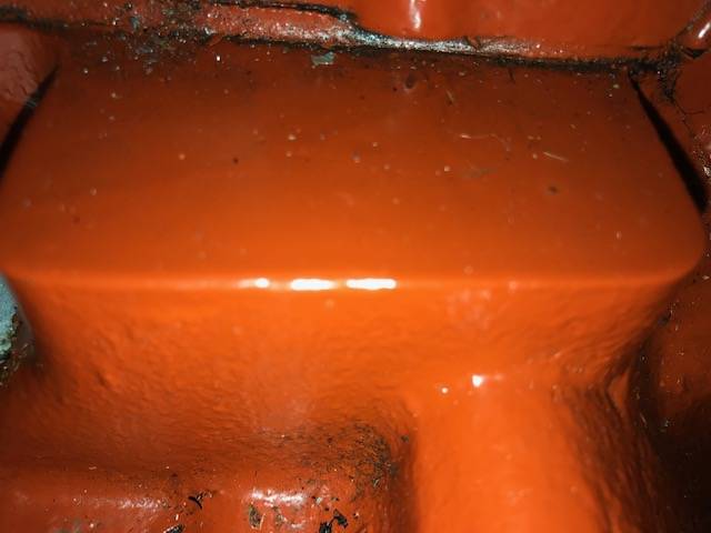

VIN stamp on 10-31-66 Hemi casting
My pad has so much paint on it that anything there is difficult to see. But I peered at it pretty closely when I had the coil off and I couldn’t see anything there except maybe the water test stamp. Bad photo but not enough there to be worth removing the coil.
My pad has so much paint on it that anything there is difficult to see. But I peered at it pretty closely when I had the coil off and I couldn’t see anything there except maybe the water test stamp. Bad photo but not enough there to be worth removing the coil.View attachment 1202667
I took a razor blade and cleaned mine off , curiosity got the best of me
I'm not that literate on those numbers, but try this. 426 Hemi 233rd day of 66, engine 0012.

I knew the Hemi engine in my 66 Satellite was not original - I figured from the casting date of 10-31-66 it was from a 67. I thought the VIN was on the back of the block above the bellhousing but I couldn’t see anything back there - hard to see - even with a bore camera. Today I noticed a stamping on the lower left rear of the block on the rear web of the block. But guess I’m not Mopar smart enough to decipher. The full stamped number is:
VIN42623360012
That obviously is not a typical vehicle VIN but I assume it does have some purpose or meaning by Chrysler. Engine assembly stamp? Or is it more likely a rebuilders stamp?
