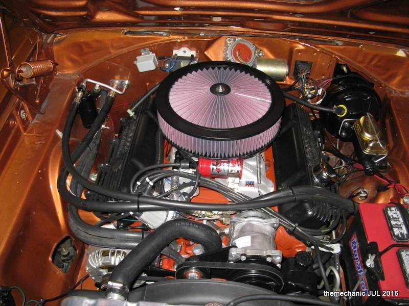

I asked the same question 2 years ago & most here steered me to Classic Air, so that's what I went with on my 68. Although they look a little different, I opted for their electronic dash controls. Everything was plug and play & the installation went fine. The only problem I had was that they neglected to crimp the metal ends on one hose. I found this out 15 months after purchase & they replaced it quickly. Just charged it up a little over a week ago & it works great.
dscf8053-jpg.293697

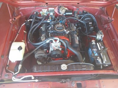

I have Classic Auto Air on my 69 Coronet. It was installed by the previous owner. It looks good and runs well.
