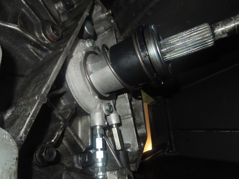

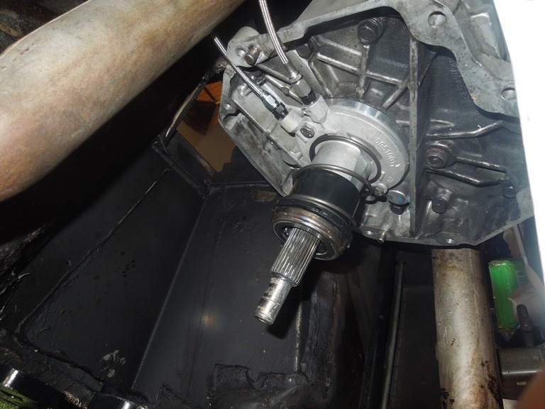

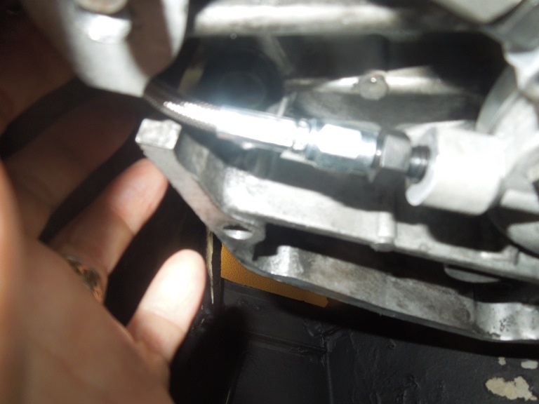

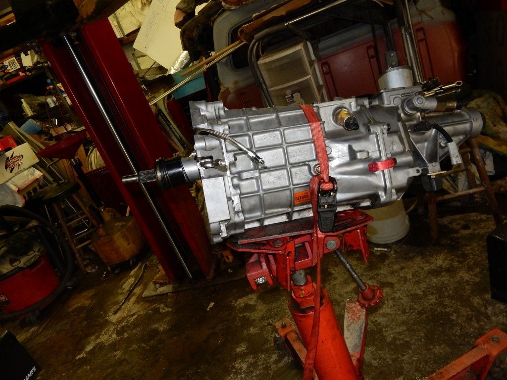

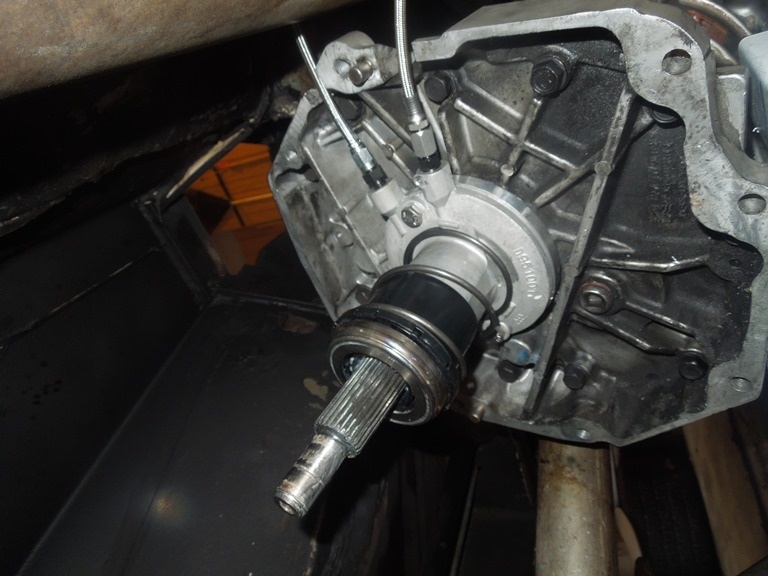

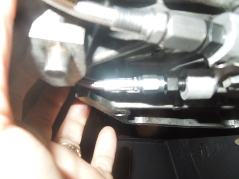

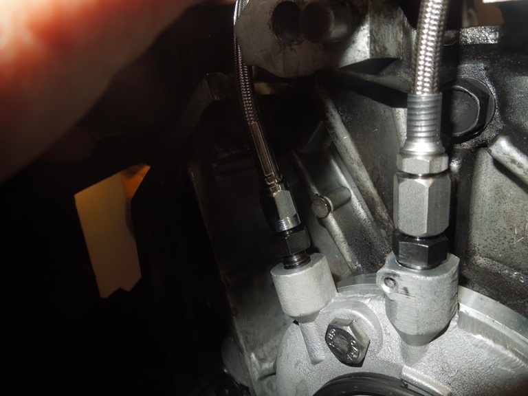

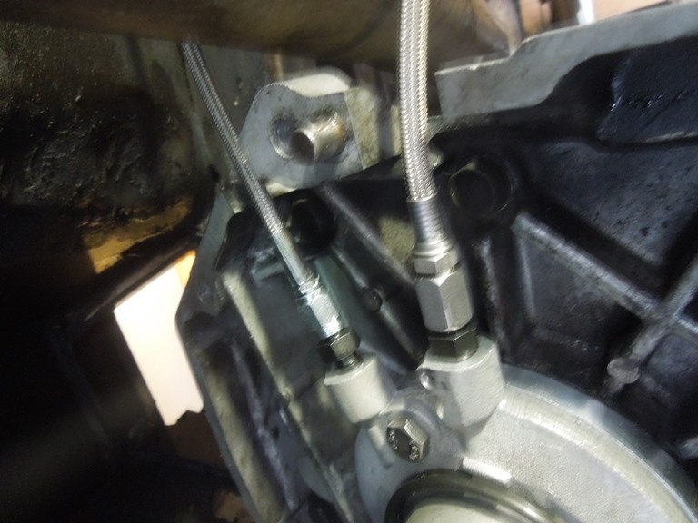

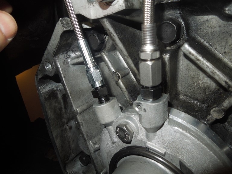

http://www.partsgeek.com/1t7lbhv-do...e+Release+Bearing+and+Slave+Cylinder+Assembly this is the one i used

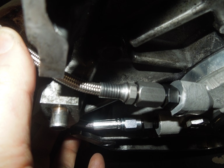

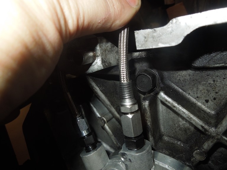

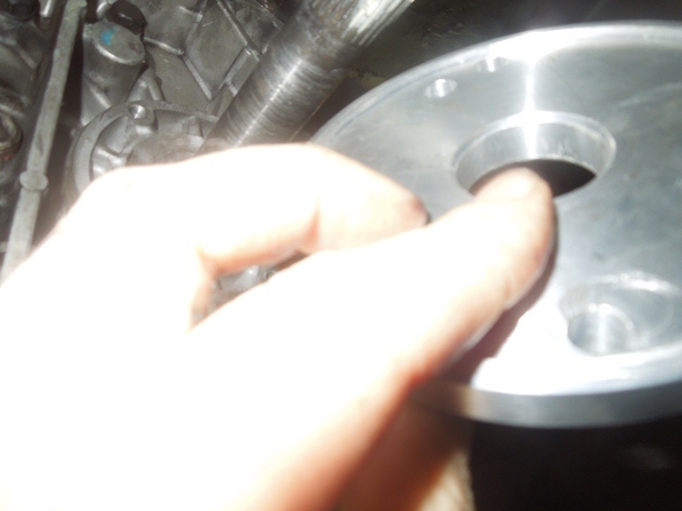

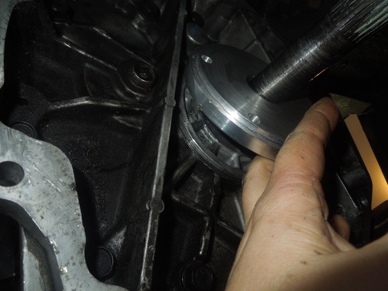

got spacer from american power train , not sure on the fitting sizes I went to thompkins Industries Hydrolics and had them make the hoses and bought the fitting that fit on right thereFor the bleed fitting, what's the size ?
And for the spacer plate, did you buy it or fabricate it ?
i didnt realize you were doing a modern hemi ? all my stuff is mated to a 440 six pack motorFor the bleed fitting, what's the size ?

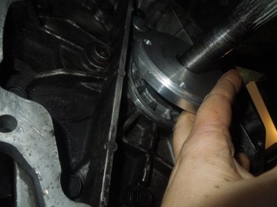

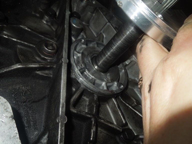

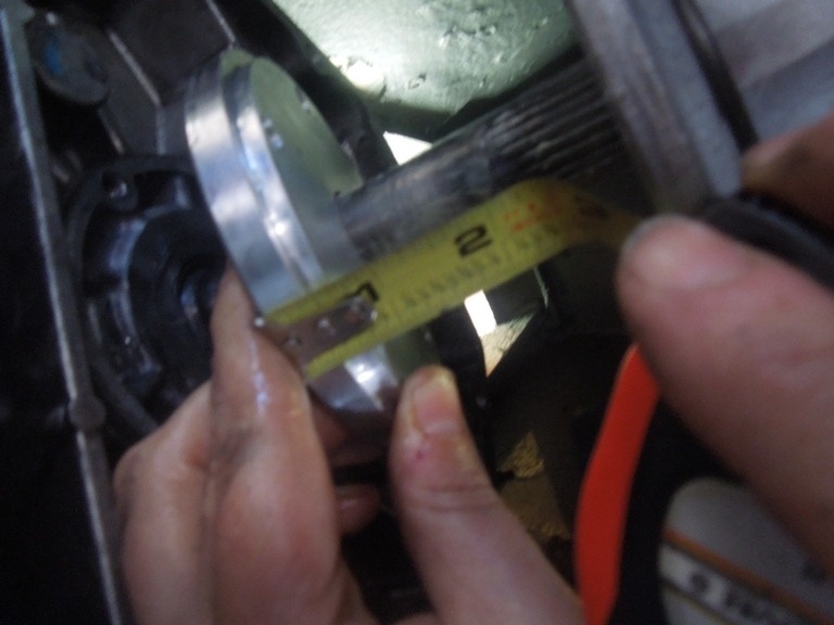

For the spacer you don't just buy one, you need to do some careful measuring. Your clutch and flywheel all come into play, if everybody used the exact same parts then maybe but I made my own and it wasn't as thick as the one Stewart showed. This thread goes threw all of that including all the parts, parts #s and how to go about it all. I've put at least 7,000 miles on mine since this thread and my only problem has been burning the clutch up after to many 1st to 2nd gear burnouts, twin disc is next.For the bleed fitting, what's the size ?
Can't say that I do, did it come in a kit? Any description?
