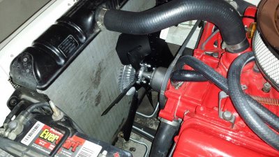

This is how I went: I had the stock tanks installed on a new 3 core radiator to keep the stock look. I had the shop sweat the saddles so that the tank/core was as far forward as possible; the stock location didn't provide enough clearance for the fan clutch. I also installed a shroud.
The fan clutch is the Hayden 2765 (I think) with a 6 or 7 blade steel fan.

I did the same thing on my '63. The Hayden clutch is a Jaguar application. Shorter shafts but seems to work the same. I had the saddles moved rearward 1/2" on a stock radiator. Works great!

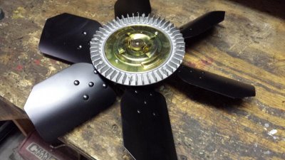

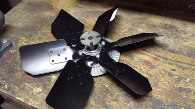

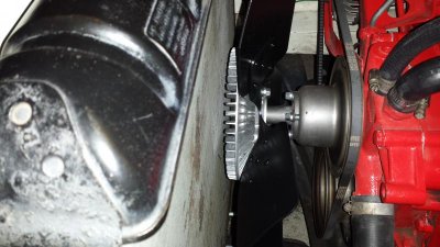

I got the first pieces of the puzzle in the mail today from Summit. 18" 6 bladed fan and fan clutch. Both Flex a lite parts (5718 and 5557). They fit very well and easy to install. The clutch is about 3/4" from the radiator, fan is the same size as stock 4 blade. Took it for a joy ride and no issues, plus I let it sit and idle in the driveway with no rise in temp. I will see how it does on extended drives but am happy with it. And my home made overflow tank is working perfect! Radiator re core is next on the list.
Nice fan - you'd think it was original Ma Mopar - except it has 6 blades, not 7.
One can only imagine how much more air it pushes (even with viscous clutch) compared to the 4 blade.
If you have 3/4" clearance from clutch to rad with a poly, I can't imagine that set-up would work on a big-block. The clutch drive shaft looks much longer than the Haden unit I needed.

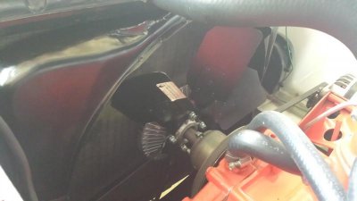

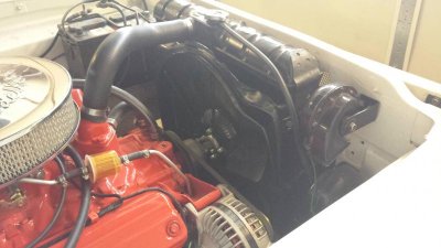

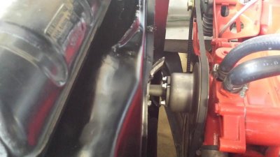

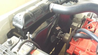

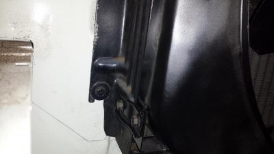

I got a shroud installed. Found a 22" C body shroud on ebay and figured I could make it work. Added 1 1/4" strip around the parameter and filled some gaps. Fits pretty good with the repro mount kit (which is expensive for 4 stamped brackets, bolts and nuts that don't fit correctly). Good gap all around. I will get the radiator apart after I stop driving it for the summer.

Thanks for these pics...very helpful!
