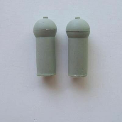

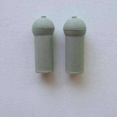

Yes they have three screws holding them on, Im good with that and have removed visors before but the thing that threw me off was the chrome shafts sticking out of the visor ends. Both rods have rubber tips mounted on the ends of the chrome shafts instead of the normal plastic tips. I think that the PO changed them out for later model visors.....66/79 based on the rubber tips.

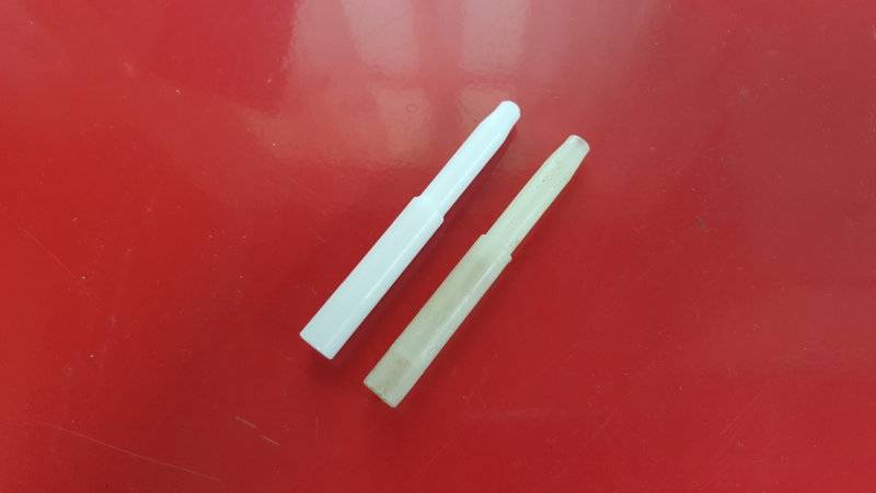

Found the Delrin tips from Kramer on EBay were the cheapest.
I should get a set of those tips. I had my visors recovered last year and reused the old tips. I never even thought about looking for replacements. I guess I just figured there was no possible way they were available. Guess it just goes to show that you never know what's out there!
Make sure they're "Delrin". There are plastic ones out there also, there not as good.

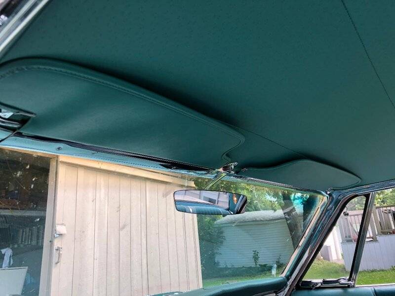

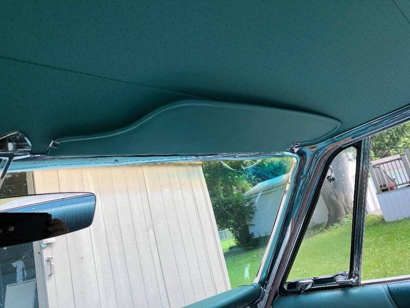

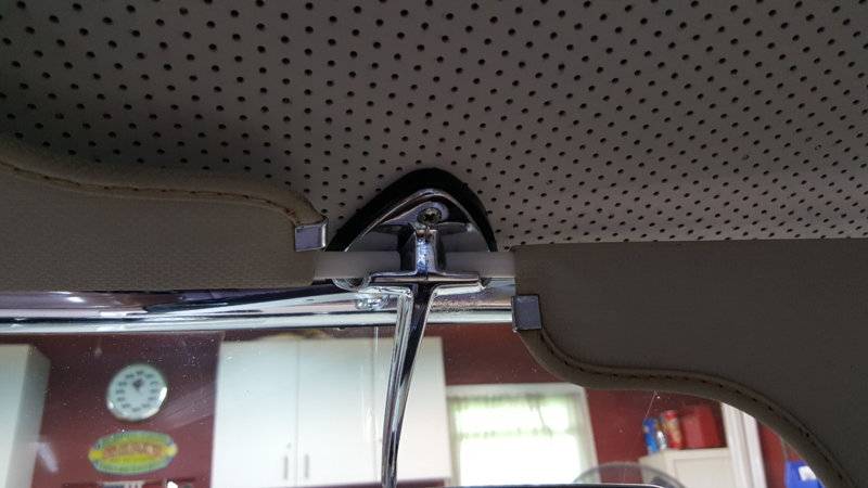

Installed the new visors today, lots of twisting and pushing but they are installed. I still need to order the correct tips....
Looks good.
10" is a lot shorter than the visor so was there a short piece of rod used on the end that goes in the rear view mirror rest? I don't remember if there's a stop in the original visor to stop the plastic end from going too far or you just have to have everything in place before you insert them as not to push them in too far.
There is a rolled piece of sheet metal in the visor that forms a tube, the plastic tip pushes into the rolled piece of metal to complete the assembly. If you look at hte photo of the tips above you will see the difference in diameter, that's where the tip stops in the visor.
