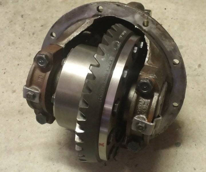

With the center section removed from the housing (in my case...a 741) how can you tell if it is a Sure Grip or Open ?
Pictures would be helpful.
Thanks !
There are two types of sure grips.
Clutch type and cone type. On the cone unit, you will see springs in the open spaces of the center section. Someone will maybe post a picture. Any sure grip will fit all the housings you listed.
The picture I attached is a clutch sure
grip. It's a 3.55 gear 742 housing.
Yup....cone unit you will see springs looking through the windows. Hard to see much looking in the windows of the clutch unit but the open diff will show spiders and other bugs :D

The open Beanhead posted is obvious, that one is easy.
As Jerry Hall showed, the clutch unit bolts together from the opposite side of the ring gear.
The cone type bolts together from the same side as the ring gear. So, you will have a circle of big bolts holding the ring gear on, and another ring of bolts on a smaller circle, on the same side as the ring gear bolts.
Ah, ok so the one that Beanhead posted looks exactly like the one I saw. I just didn't know by looking at it. Now I be edjumicated !! Thanks for the lessons folks !
